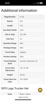

m1008 is prob right. The specs show only 46MOA adjustment, almost the same as my problem scope. Can you get that rail off or is it part of the recvr ? The 30* is your prob, not the scopes.
