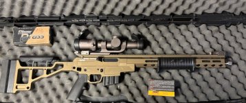

Not a long report, it was a cold day on the range so I only did about 150rds. I took my new Taipan X out to basically sight it in. Impressed with quality and the fact that the upper and lower are bolted together, you don’t get that AR slight wobble between them. Ultra smooth cycling especially with the spring assist feature. After I had sighted in the rifle, I tired a couple of fast firings and did two 10rd dumps both just under 5 seconds (remember this was my first time with the rifle) and kept both groupings in a 6” circle at 50m. As for accuracy I did 6 five shot groups with my hand loaded 55gr rounds and 4 five shot groups with the 62gr PMC green tips at 100m. The rifle did very well with both bullets but did seem to like the 62gr a little better. 55gr groups averaged 1.29” and the 62gr groups averaged right on 1.15” (based on 100m vs 100yds this is almost exactly 1.0 MOA). Someone with younger eyes and with a higher power scope (mine is a 1-6x LPVO) could obviously do better. Only downside I have with the rifle is the trigger and it’s the same complaint voiced on videos from Australia and that is the trigger pull is very heavy. Good news is that apparently there are lighter replacement trigger groups that can be bought for the Taipan bad news is that I will have to order them from Australia. The Australians designed the Taipan X so you couldn’t in your wildest dream say that it is somehow related to an AR, obviously no gas hole in the barrel, no gas system, nor space for a gas system, upper and lower are not AR compatible, the bolt and carrier are not compatible with any AR design and even the trigger group is not compatible with AR style trigger groups (you would need to drill a extra hole in the receiver). I like the new rifle and it will stay in my collection regardless of what happens in the coming months/years. Coyotes beware.
