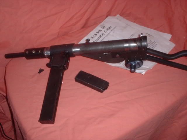

The partially completed gun. It still needs the front sight dovetailed in and beadblasting/bluing.

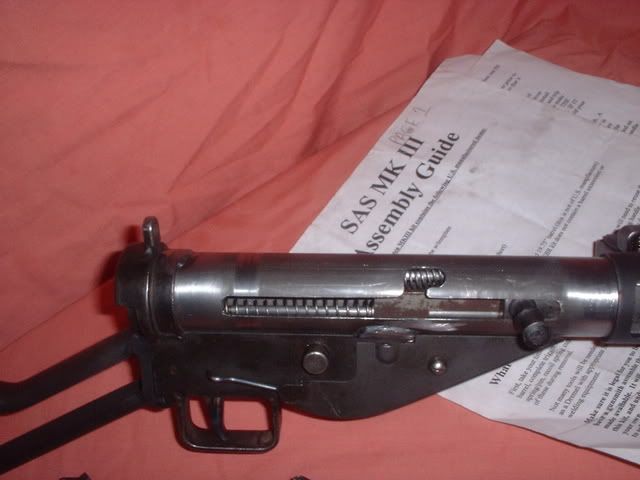

A view of the left side. The cocking slot is indexed at a different position of the casing to prevent the installation of a turned down F/A bolt.

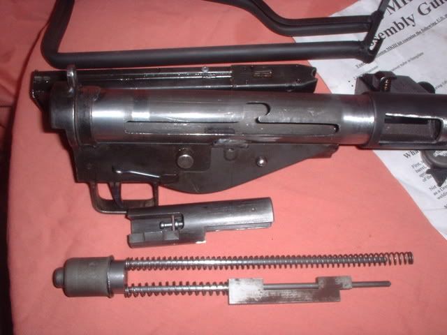

Here is a photo of the internals. A bit crude, but I'll get them to work.
