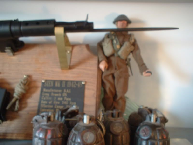

The bayonets at Hercules I mentionned were the Sten bayonets like the one in Stencollector's photo. I, too, have seen the buckets of No. 4 rifle bayonets being sold cheap enough to use as tent pegs.

Yea I hear. most of my family live in the US. The bayonets were enfield bayonets. but enfield bayonets were the same for MKV stens I though?
The end of a Mk. V barrel has the same lugs for the front sight and bayonet as a No. 4 rifle, so any bayonet that would fit a No. 4 will fit a Mk. V.
