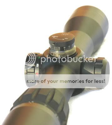

Falcon Menace 1.5 x 5 x 30
The unit is a slight bit heavier than the Leupold MR/T Mark4 M1 3 x 9 x 36mm I mounted and competed with many years ago. At that time, I thought that this scope is ideal for our Matches 1-12 and the odd CQB matches. It was until my son had to attend Queer's Univ in Kingston. Now I'm back to being on a tight budget, hence the purchase of this Falcon Menace scope. Oh yeah, I bought it online from Mike at www.allengunworks.com (board sponsor). He's fantastic to deal with!

The knobs are not tall like my Mark4 M1 turrets that I like to adjust without my reading glasses. They are short and finger adjustable. Keep the protective caps in your zipped (ziploc'ed) pocket in your gun case so you won't lose them. I shoot without them on, never lose them that way. Keep them stored in the original factory box, always know where to find them. ;) The knobs need a super small Allen key (included) which resides inside my Magpul MIAD grip. Yes, there are THREE little set screws needed to loosen off the turret ring and 'slip your scales' after you zero at 100m, then I rotate the freespinning turret to "0" position.

So back to slipping my scales, 3 little set screws just like my older Leupold VariXIII target knobs. I was spoiled with my Mark4 M1 & Bushnell Elite 3200 10x Mildot units that only use ONE screw! Falcon engineers, take notes! :eek:

Windage knob- Yeeeha!
The Falcon engineers did their homework with the windage knob. Sure it's as small (or large) as the elevation knob/turret, but this one is marked most differently. It's not marked 0 to 14 MOA, like the rest of my Leupold scopes. It's marked 0 to 7 as you dial LEFT windage (put left windage on) and 0 to 7 as you dial RIGHT windage....
Now you know how far left OR right you have added for windage at one glance! Back with my Mark4's, when I saw index 3, I knew I was 3 MOA RIGHT windage... When I saw index 12, I had to remind myself I was 3 MOA LEFT windage (or something like that). I'm putting all that behind me as I prepare to buy my SECOND Falcon Menace.
