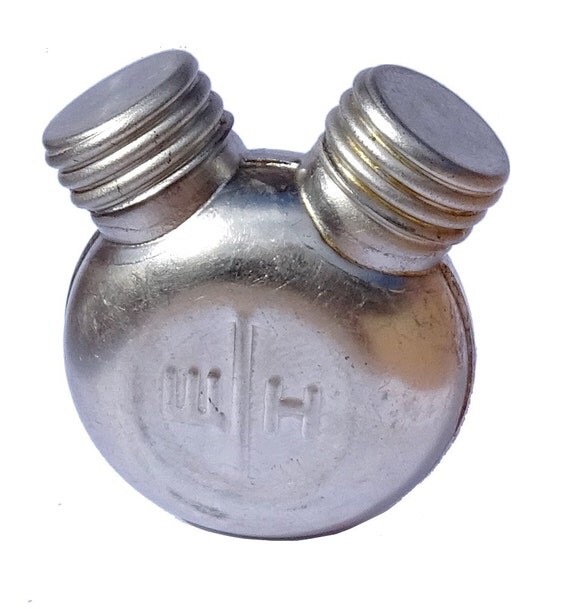

All you need is patch of Щ which is soapy water out of bottle below. Pass it through the bore and gas tube. Then dry patch. Repeat if necessary.
Then from same bottle below take patch of H which is any oily compound like 10w30 and pass it through all gas affected areas bore and gas tube. Wipe all parts down and reassemble the rifle. Done.
Soviet soldier had 15 min to clean his rifle at the end of the day and sergeant would time them. You do it often enough and you can do it in 10 min.
