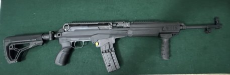

I got the hical one and like it. Call the store if you want one if inventory shows 0 online.
