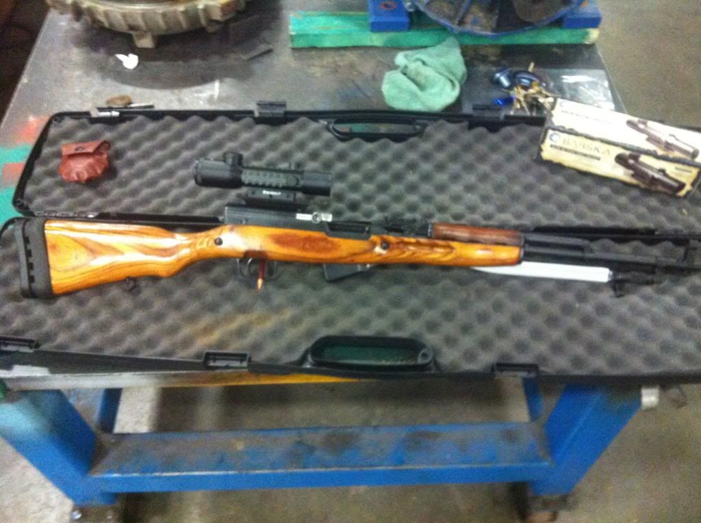

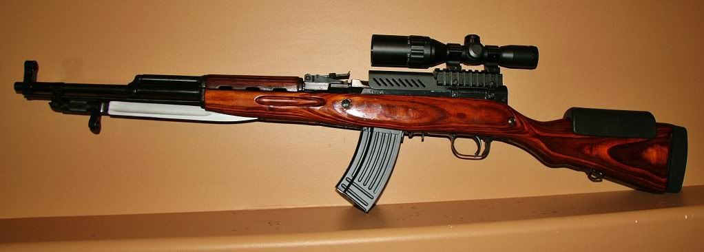

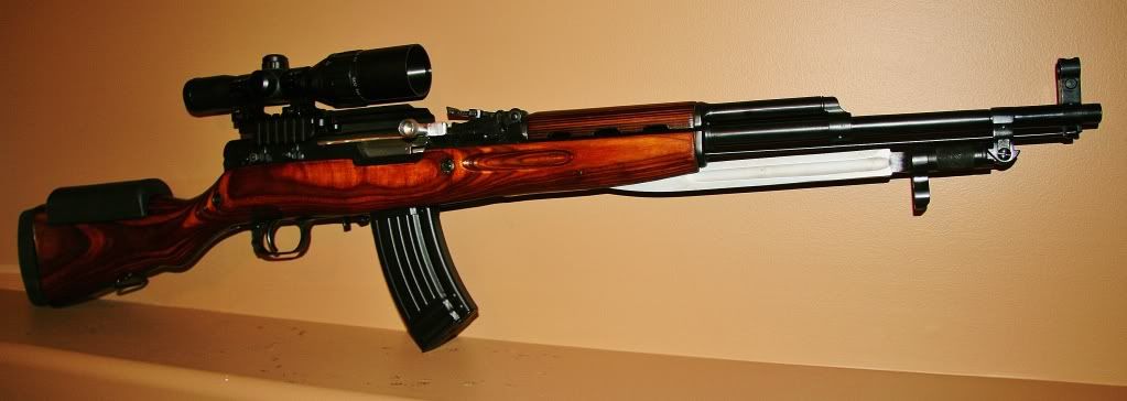

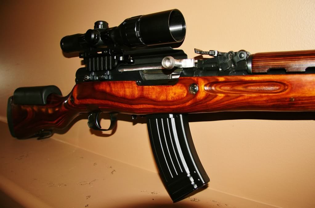

WE went the easy route on these SKS's... UTG Tri-Rail receiver covers were filed down for very tight fit... installed bolt buffers and "scope-protecting" shell deflectors... mounted UTG 4X32mm Bug Busters... this inexpensive set-up is holding up... POI has not moved yet... thru 500 rounds (fingers crossed), pinned mag (5 shot), 1" butt pads, and Choate cheek pieces;
Where did you get the cheek piece? I tried looking around on the web and I don't see one made for the original SKS stock. Thanks.
Well I had this kicking around for the last year, it was suppose to go on my mosen but well it ended up on the 150$ sks lol
one thing only the cross hairs are a bit blurry any reason for that ?

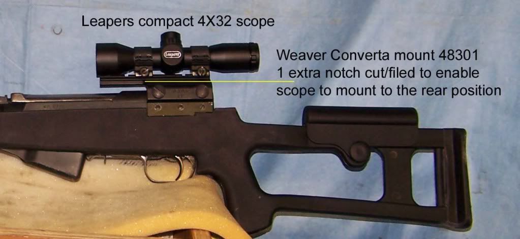

I was just glancing at this thread and thought I'd throw in my 2 cents worth.

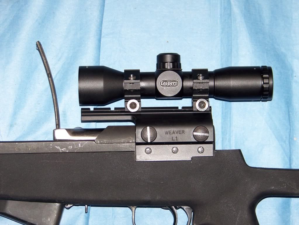

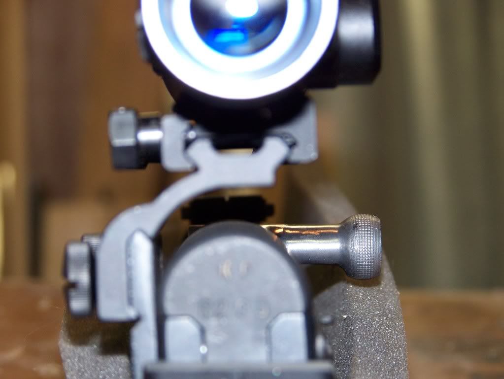

Check out the Weaver Convert-a-mount. A few options depending on how high you want the base to sit with reference to the body cover and how high you want the scope to sit in relation to the irons i.e low or high. My base is high with a low mount, can't use irons with scope on. I could put on a higher mount if i wanted to use the open sights at the same time. Apologies if someone already mentioned this setup.
I've cleaned up the bottom edge of the base to make it straight since pics were taken so no more step on the base.
