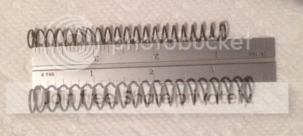

When did the "new" ones start using double recoil springs? Boris on the grand power forum that you moderate says there are different colored springs for different power .22lr's and that they are used in combination. I don't see that with my new to me MK 12 and there is no mention of it in the instruction manual. Were these spring packs added to improve function? Are the models that Dlask just sold compatible?
Re-read that forum post. Boris was answering not about the .22lr discussion above but the X-Calibur
Yep. Dlask Arms got the older version with two separate springs. They also got the small box versions of most of the guns without the spare back straps.

I bought my K22 XTrim from Dlask last Dec and it came with two springs. One in the gun and one in the box. Can't remember which one it came with installed.
If there is a new set that will make this ultra-picky gun work with more ammo, I'd like to get it please. Just let me know which channel to go through to provide my shipping info.
Looks like your springs are different diameters? Mine are the same but I wouldn't be surprised if the springs have been mixed up in my case because the gun was sold earlier in the year and then returned according to the information that somebody allready filled into the manual.... Dlask does not remember why it was returned?
The second spring in my X-trim case was the same as the one in the gun but an 1/8" longer.
The K22s had a bigger spring that looks like your big spring, this spring is so big that it does not rest on the stop at the end of the guide rod like the smaller springs do but instead rides over it and down a ways. Nice to have a few options but I do notice with the larger spring there is alot of spring vibration going through the gun when dry firing....sort of sounds like a springy striker fire pistol.
