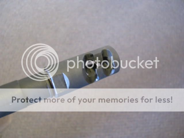

Here are pics of the brakes I have been using. All are offered by Dlask Arms in Vancouver. Dr.Lector on this board can also help.
This is the gill brake that has really impressed me. No muzzle jump and what little recoil is left is wiped out. Very nicely made. Bore it true.
There really isn't a huge difference but the 'top' of the brake is more open. If you flip the brake, you will find way more muzzle jump.

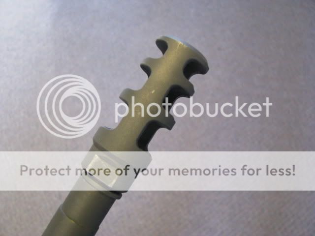

This brake I didn't like. Lots of sharp edges to catch stuff, bits of powder blown back into face, feel the concussive blast in your face. Recoil reduction would be considered med and a bit better then the YHM FH. Not recommended.

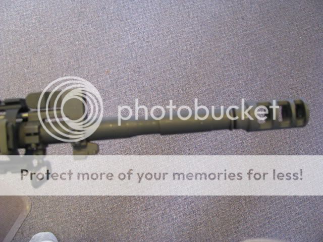

Nice looking Vortex type FH. didn't shoot in the dark but it is well made and finished.
Very nice gear from DLASK ARMS...

Dlask Arms was making them. personally, I wouldn't use them. This was the worse of the 3 brakes I tested for blow back and only offered moderate recoil reduction.
Plus all those 'horns' was great for hooking up stuff and lint.
Jerry
Good posts Jerry, particularly your observations about the Dlask A6. There are also some other features about the A6 that you missed, it's a very well designed brake. It was also extensively tested using strict methods.
