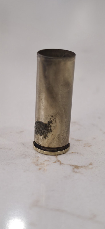

Here's the casing that was stuck in mine. You can see the rough marks on the brass too. This was the one that gave me trouble extracting.
What's stuck on the side of the casing?
Scraped it off with my fingernail. The particles are actually shiny greenish/grey granules, so I’m thinking it may be unburnt or partially burnt powder mixed with carbon. The brass underneath looks smooth, doesn’t seem to be pitted.
