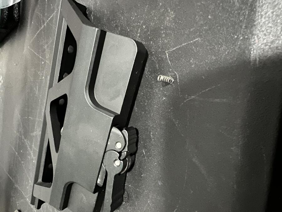

Went to attach my pic rail to the mount, opened it up and this spring comes flying out…… trying to get it back in but it’s a real pain, not sure what happened exactly as to why it came out. Unfortunately I deformed them spring trying to get it back in :(

You backed out the retaining screw way to much thats what happened.
Nope did not even touch the retaining screw, was going to check how it fit with where it was set already, just opened the latch and heard something drop. Although maybe it was fairly backed out from factory and when I opened the latch it went for a ride. Might be able to find a spring from something else and try and get it back in.

I would suggest a trip to your local gunsmith, probably your cheapest and best option.

that happened to me too it required the lever to over extend to the 180 degree point so the tab extends down and jam the spring back in the hole, then bring the lever back to its regular position while holding the spring and pushing it into the hole. took me a few tries to get it but it is doable.
hope this helps

Thanks! I ended up getting a spring back in seems to be fine now :)
