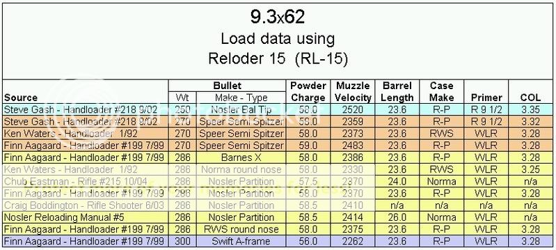

This one has been making the rounds for some time but the information is still valid and the sources cited are a who's who of gunwriting. It was based on this data that I developed my 9.3x62 load with 186gr Norma RN.

BUM - Good loads there with RL15. Have you played around with RL17?
My two favorite powders in my '62 are RL15 and Varget with the accuracy and velocity edge going to Varget. With both I use 58-59 grs. Velocities are 2350-2400 fps out of a 21" barrel.
Haven't tried it at all. I know there were good results acheived with it and it could probably offer another hundred or so FPS but I'm not sure that I'd want to have that much fun with my rifle weighing 7lb 11oz. I would be willing to bet that it could make the 250 Accubond trot right along and flatten the trajectory out a fair amount. Could be a good open country loading.
BUM - yes, it might make for a good open country load. Lapua data shows just over 2600 fps with the 250gr Accubond and the new(ish) N540. That would give you a PBR ( +/- 3") of almost 275 yards. Not bad at all for an old "short range" chambering. ;)
The thing with RL17 is that there is no reliable book data for its use with the '62 so folks may be reluctant to experiment. My research told me that burning rate is very similar to H4350. So I tried that. Started at 64 gr and went to 67. No conventional pressure sign(primers still rounded and tight, easy extraction, no extracter marks on the brass). But I've also read that pressures can go from ok to 'holy s___" with a small increase and with no warning.
At 67 gr, my velocity was 2454 fps out of a 21" barrel. Recoil was brisk with my 8 lb rifle.
