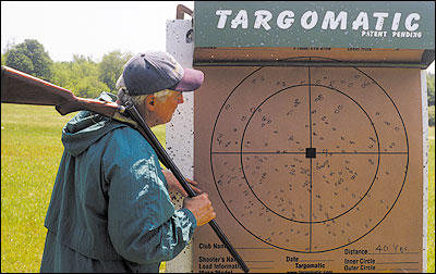

What do you mean pattern the gun? Do you mean select which brands of ammo spread better?
I went to my first Sporting Clays shoot last month. Got 30/50 with my 870 pump. loved it. I'm looking into a used o/u now.
Patterning the gun is simply shooting it at a dot in the middle of large paper target to determine where the spread of shot ends up. It'll show you if the gun shoots high or low based on where you're aiming as well as how tight or loose the shot is (depending on the choke).
Shot my first round of sporting clays last weekend, only got 25/50 so that seems to be the normal for new comer to the sporting clays, but then again, all the courses are different with differing lvls of difficulty. In terms of which one is the easiest, I would say 16yd single trap is definitely easiest to get started on, but you can build on the difficulty by doing handicap and double trap.
Patterning means shooting the gun at a board or large piece of cardboard from a set distance, to see where most of the pellets are going. It gives you an idea of what kind of spread you are getting and what chokes you should be using, for example you will see if the pattern opens up to the point that the clays can "slip through" the holes.
Properly patterning the gun involves shooting it at a patterning board from a distance of 40 yards. The board will have an aiming point in the middle, and a 30 inch circle around it (or you will have to draw the circle yourself). You then count the number of pellets that hit inside the circle, and you quarter the circle to figure out of more pellets are hitting in the top/bottom/left/right halves.
An ideal pattern for a "full" choke would mean that 70% of the pellets that came out of the shell are inside this circle when shot from 40 yards, and obviously an equal number in each quarter. Other chokes are roughly supposed to pattern as follows:
Full: 70%+
Modified: 55-60%
IC: 45%
Cylinder: 35%
A 1oz load of #8 shot will have roughly 400 pellets, so be prepared to spend some time counting holes...
Quite often a choke will not actually throw a pattern as advertised, it depends on the kind of ammo you are using etc. Very large pellets, such as in Buckshot, will not react the same way to chokes, so this should really only be used with shells that have a fairly high pellet count.
