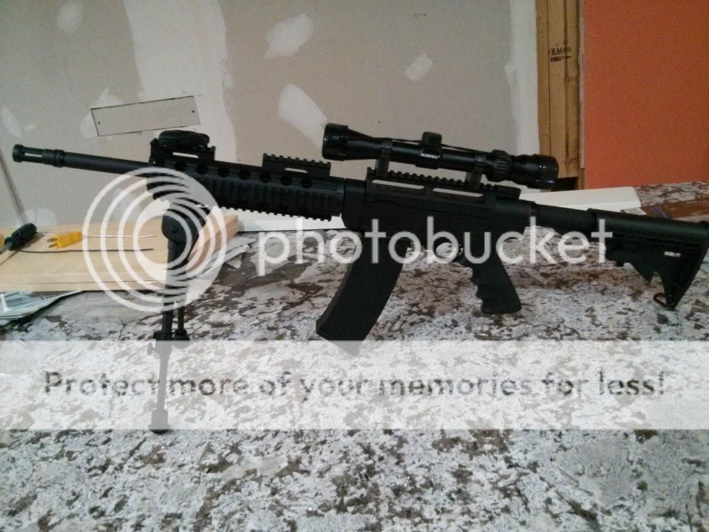

Not exactly a short barrel, but have to give a shout out to Tom E Gun for answering questions and providing links to his build.
Had to take it half apart to apply locktite, so hopefully I can really work it out once I get home from work in a couple of weeks. Dlask rails, Bushnell .22 scope, Archangel magazine, 8"-13" bipod, added the rubber pad from an AR stock to it and removed the front RDS as well.

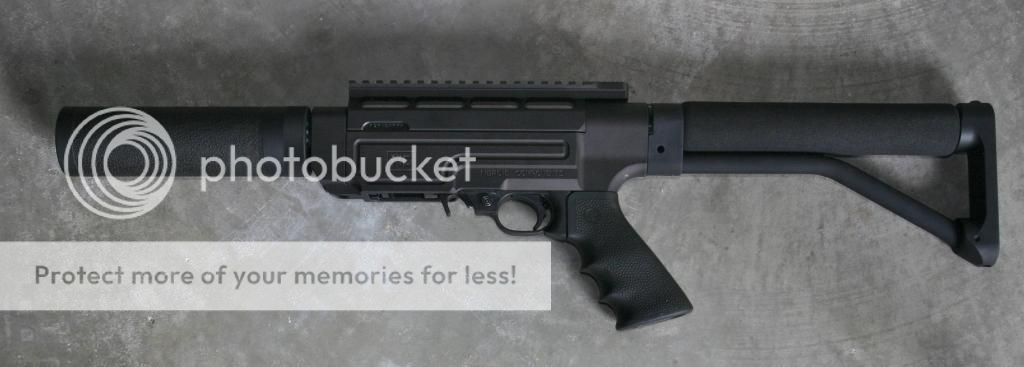

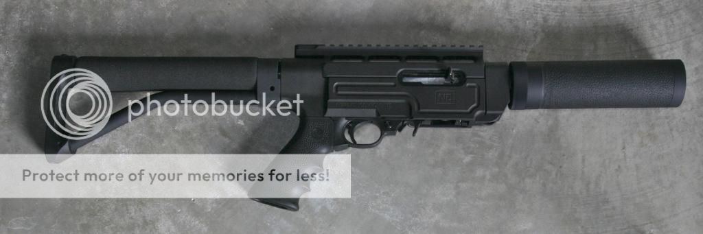

New SR-22 Build
I thought that for fun I would do another SR-22 build. I am going to try to sell this on the EE to cover my expenses. Here is what I have:
Here is what is included, all items are brand new and unfired:
ARFX stock with all hardware, (sling swivel and rubber butt pad included but not shown)
Nordic/SR-22 3 piece chassis (all fasteners and gap filler included)
Ruger 10/22 receiver, bolt (50th Anniversary), charging handle/spring, V-block, screws and 10 round magazine
Hogue pistol grip and carbine length fore end (all fasteners included)
The only items required to finish the build are a barrel, a muzzle device and an optic and/or sights
Here is the link to the EE ad: http://www.canadiangunnutz.com/forum/showthread.php/1114252-Brand-new-unfired-sr-22-kit?p=10379904#post10379904

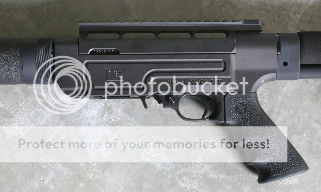

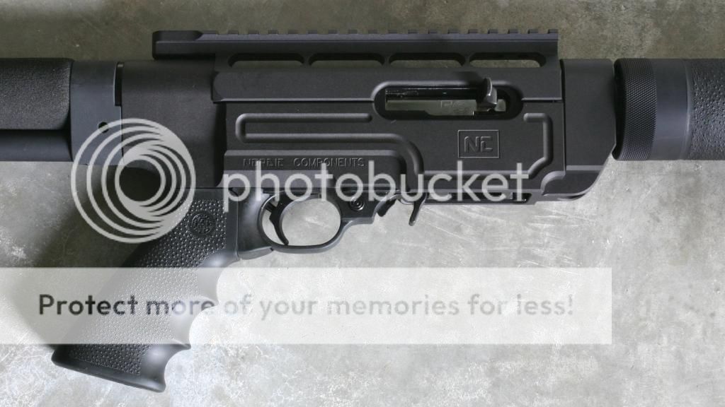

^ your upper & lower fit better than any Nordic/Ruger SR chassis I have seen. All of the ones I've laid hands on had some kind of gap along that seam. Did you do anything to make the fit so precise?
Now that I have screwed on the pistol grip, I notice that the chassis does not quite fit as well, so I suspect the attachment screw is too long? Should be an easy fix.
Hmm, that is odd. I didn't think the PG screw would contact the action.
