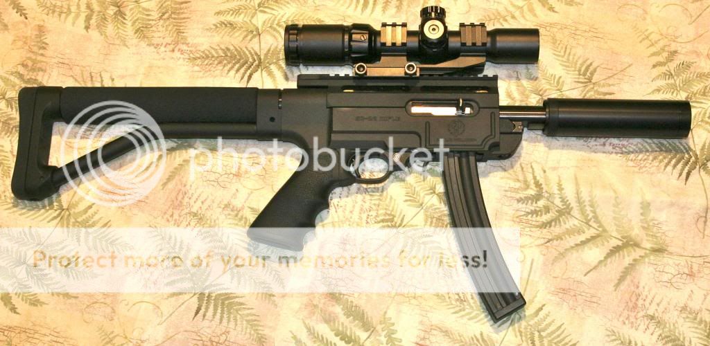

A quick mini update. I am still waiting for the adapters and 4" hand guard to arrive. In this pic you can see the new barrel shroud and the new Archangel mag I ordered from Wanstalls website on Sunday (arrived today!):
Looking good bro! How does the mag run? I've spent 10 hours at the range over the last week trying to get my mags to run... Total bs!
To be honest I didn't buy this mag with very high hopes for function. I mainly bought it for looks. Because I am building a mix and match style SR-22, I thought it would be a good combination. This mag also comes with the .223 style mag sleeve, but I think I prefer the HK MP5 look of the inner mag shown in the pic. I have a variety of Ruger and BC mags I have been using for a while that function just fine. I also bought one of the H3Cr mags because I have been wanting to try these ever since i first saw them. I hope to try the H3CR this weekend and I will let you know how it goes.
My HC3R are running fine in both rifles... it's the Battledyne mags that are worthless.
Test the Archangel mag instead!
Sweet set up TEG! Do I read that right that wantsalls sourced you the shroud and the mag?
