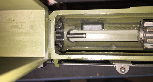

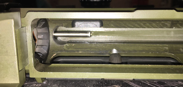

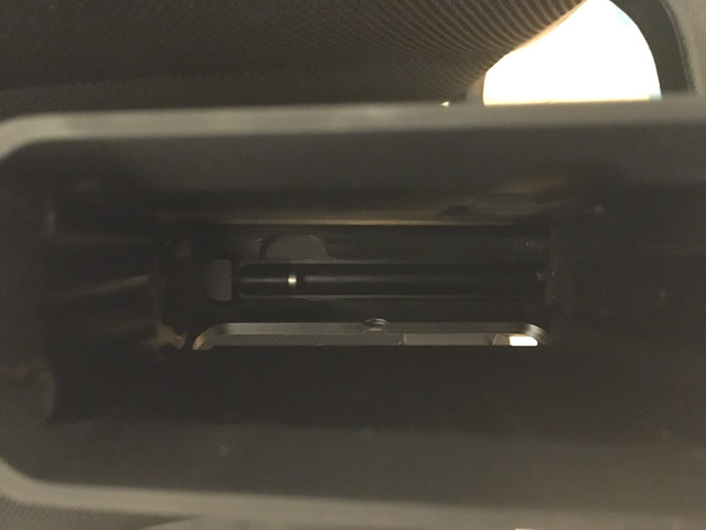

Hope this is of interest.
Image 1: Original BCL102 that used an standard AR15 Rifle length gas tube
Image 2: Replacement Fulton Armory Rifle Length barrel and Armalight Gas tube (no issues)
Image 3: Stag10 Build with BSF Rifle length barrel and AR15 style gas tube (no issues)
Thanks CODfan!!! Thats exactly what this thread needed. now we just need to make your post/pics a sticky, and if people could start measuring bbls then we can get a data bank of what bbl takes what gas tubes.... just in time for all of these to get banned probably but.... meh.
