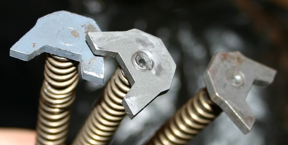

- I took some pics of the old style recoil guides and will explain the problems we have had -- there is no danger to the shooter (other than the fact his primary no longer works) if the part fails.
I will upload them after dinner

Here are the pics of the recoil guide and springs I took.
These three are used -- but scavanged out of guns removed from service - and I brought down to fill the void.

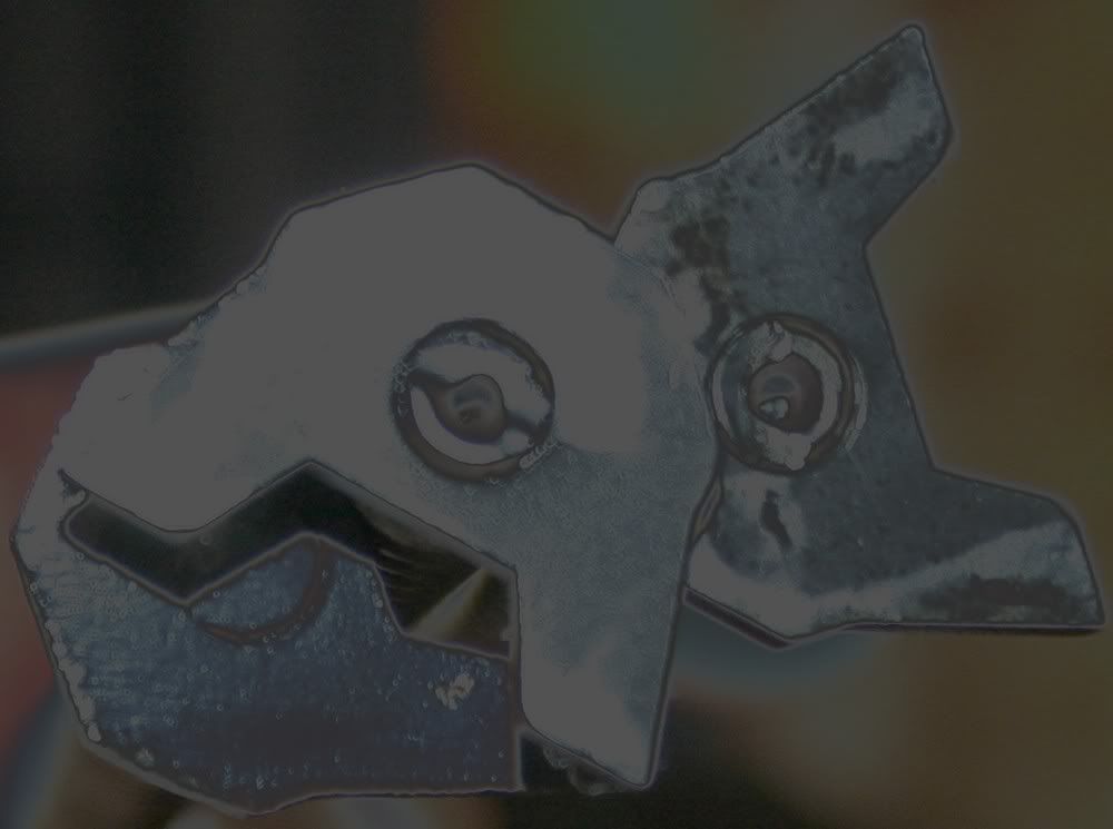

I played with contrast on one pic so you can see the area that are being abused -- one looks like it is still GTG -- the other two look like they may be on their last legs -- and there seems to be two or three different versions -- all of these guns where brought in on a US DOS End User at the SAME time...

If you want confirmation send me a pic of the gas valve. The new updated ones are silver. The gas port pressure issue concerns full auto use in the SG552. So there should be no problems on any CQB. The breakage issues all resolve around the recoil spring guide, and from there the bolt carrier. They have never effected lock up, or receiver life.
If you look at KevinBs pic, you can see that the spring on the left is also shot, the springs need replacement periodically too, just like any other system.
