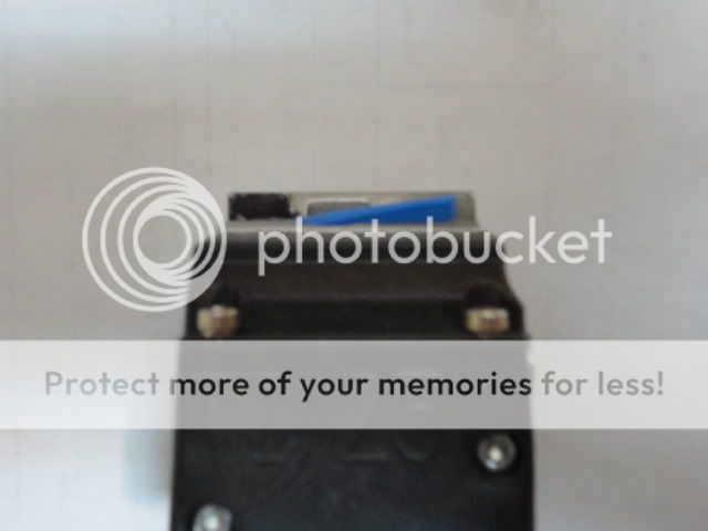

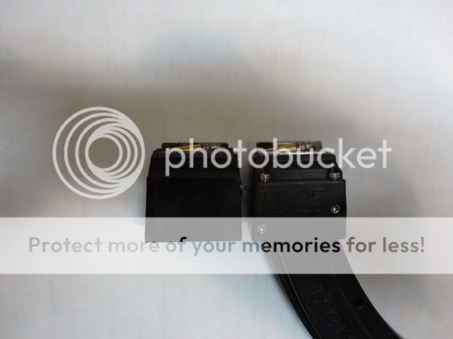

And both T.I.'s showing follower angle:
If the promags can feed 32 rds reliably with alot less angle on the follower, then why do the T.I. mags have so much angle to them?

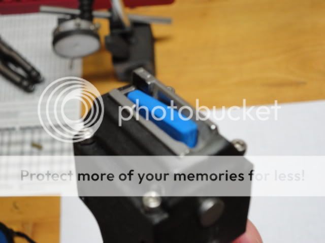

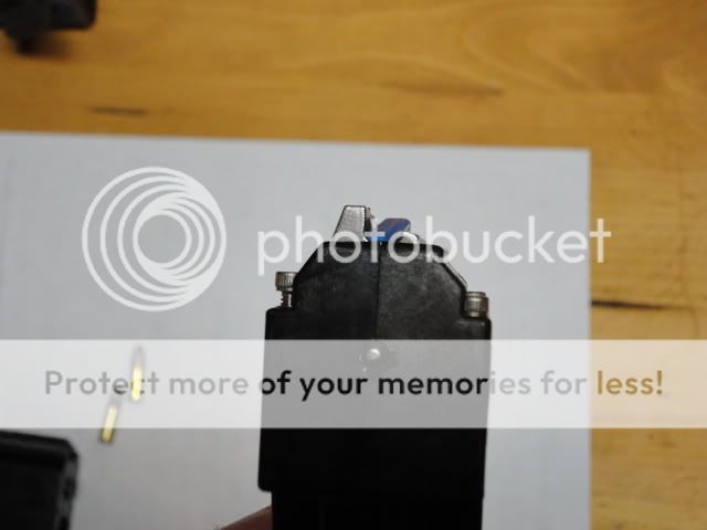

This is how it looks now
Fit is "really" tight and notice that the screws are not ajusted equal on both side.
Also, I didnt rounded the follower like it was before
Hope this help, good luck
