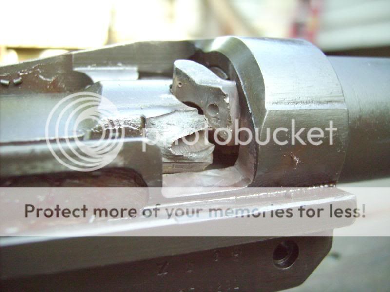

Here is an example of a gun where the lugs bore unevenly and the bolt failed. In this case, according to the CMP folks who examined the rifle afterward, only the right lug made contact and the left lug had been out by a gap of only .0035".
You can see the bearing lug sheared off and luckily the second lug held.

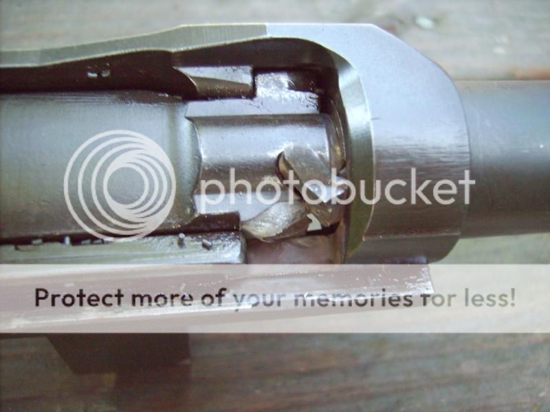

Another view:
