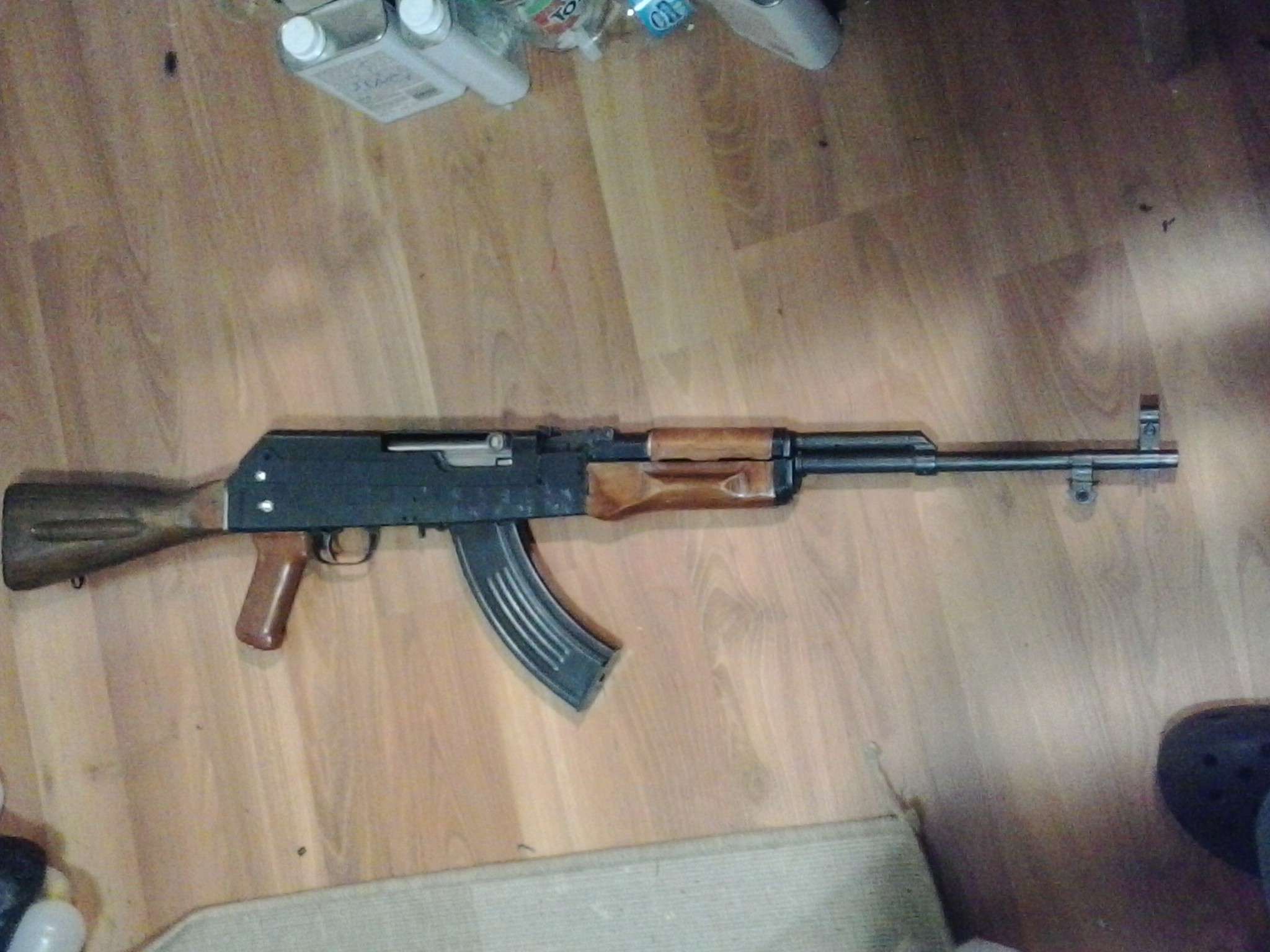

The AK- SKS kit ( little update post 440 2015-03-19)( less ABS more wood and metal)
with the metal magazine , still without the mag release , but didnt got time this evening to work much on this ,
got my wood stock from irunwood design , just have to find how i finish it , i was maybe thinking to stain it in a nice red or maybe blue
somebody have any suggestion ?

still dont have the mag release in this picture , i have to reprint the frame thicker to be able to install it , not perfectly happy with the results with the finishing of my stock the stain was suppose to be more a grey and it look like more grey/blue on some spot , might retry when i got more time to redo a better job ,
this week-end i printed a new frame , with some light adjustment and a little change in the look , it will probably be the same in the final version , added mag release , still need some adjustment on it , a little bit too long at this moment , added a hole in the handgaurd adapter for the cleaning rod , because that look a little bit weird without it ^^, i have to source an ak buttpad or just print one , i will be good to lower the dust cover of maybe a .030 i think
weell didnt work on it this week , i tried to print a new dust cover with osme adjustment and an upgrade in case a trouble appear , but didnt took the quotes right so the parts has no fitting .... 15 hour for nothing at the end ,
still have to work on the printer , new base to mount the hotend that should helps to make better prints , might be able to test shoot this week-end
