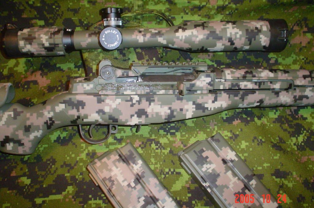

I painted rifles as a side business in early to mid 2000..............I no longer do this due to the time involved that kept me away from my family, and the fact that everyone and their dog is doing it these days.......
As to price, with dis-assembly, paint prep,actual painting, and re-assembly for a rifle with scope in digital camo, I charged roughly $400.00 to $500.00.................

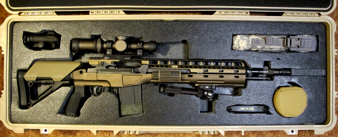

what frontend rail is that?
Ultimak M8... I Like that it is no higher than the Handguard. If I take the scope off with my quick detach rings, i can still use the irons. I ordered it from Brownells and had to pay customs fees. M14.ca later came out with similar rails which i think would be the same or potentially better.
Thanks for reply, that's what I thought, looks same as for Mini 14
