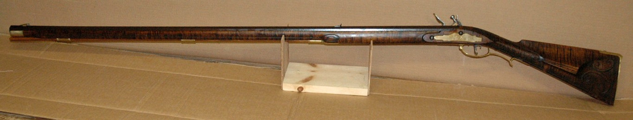

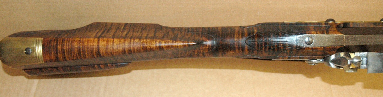

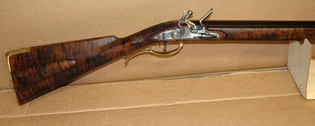

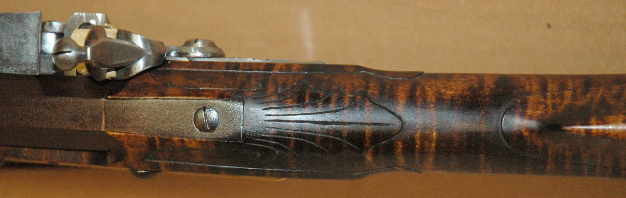

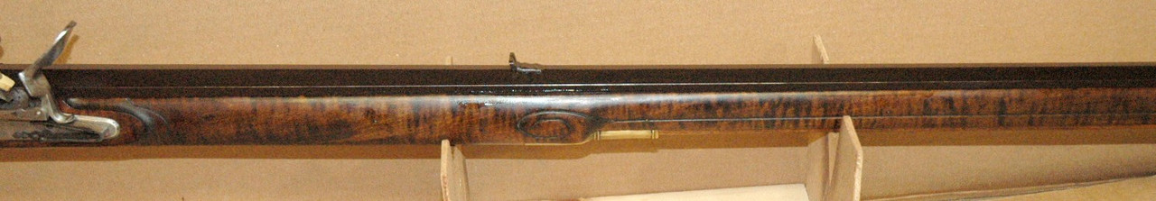

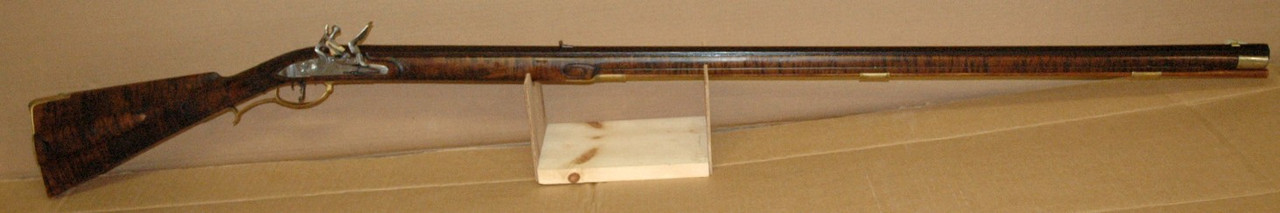

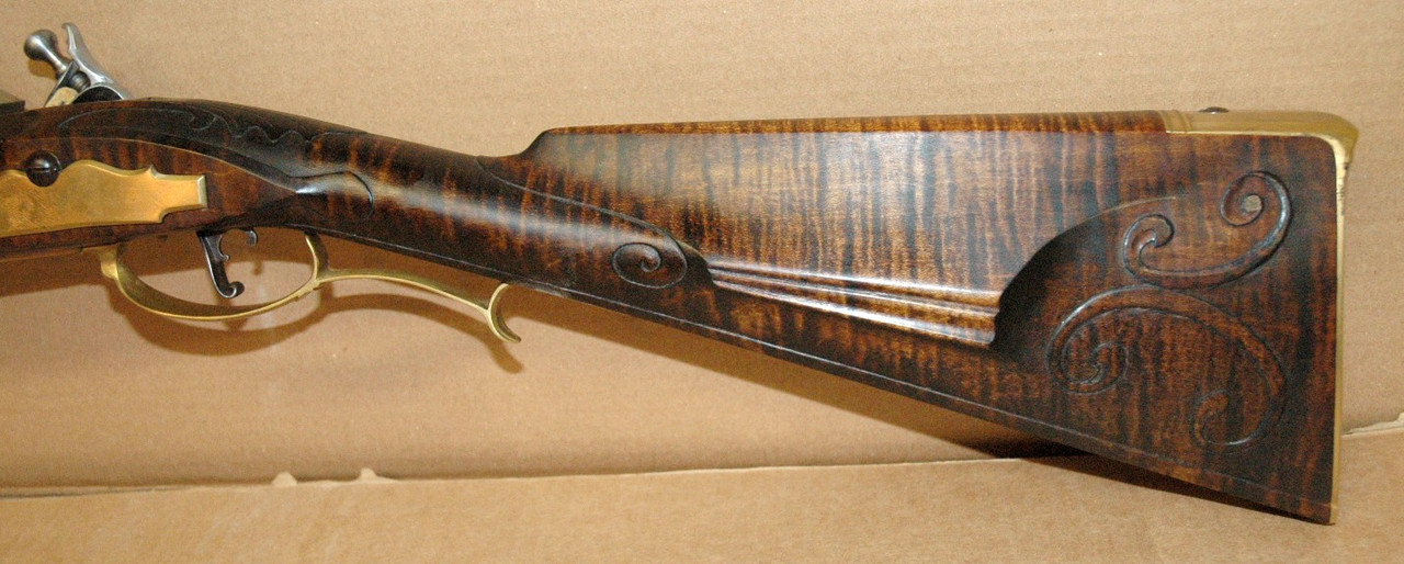

This was is my last build - recently finished.
It is in the Early Lancaster style (roughly 1760-1785) and was built from one of Jim Chambers kits.
The barrel is a swamped 44" Getz in 50 cal with a coned muzzle.
The lock is a chambers.
The maple stock was finished with aquafortis and boiled linseed oil.
The finish on the barrel is slow rust browning.
This was my first attempt at carving, so please be kind ;)
Now, I have shown you mine; let's see yours
