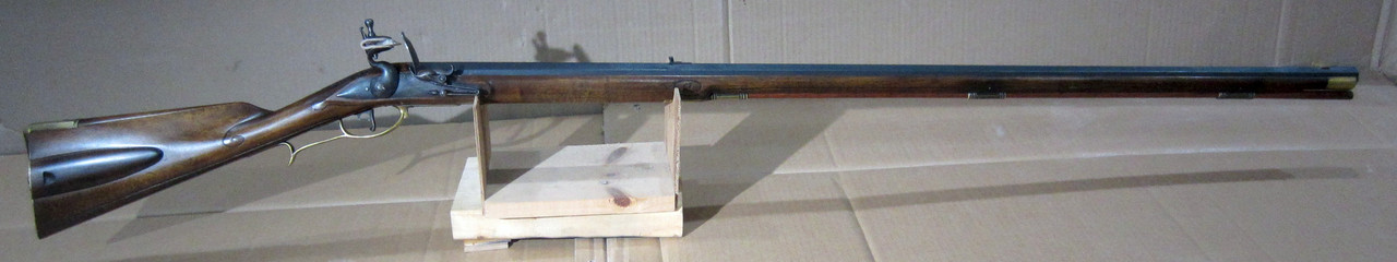

Just finished my latest project.
It is intended to represent a longrifle that might have been built in Augusta County, Virginia between approx. 1760 and 1780 and is my first attempt at an aged finish. The objective was to make it appear well used and well cared for, but not antiqued. I might end up knocking back the shine on the stock and really should do something about the color of the rammer. I might also add some wear to the barrel.
This was a plank build of my design.
The 54 cal. swamped barrel is a 42" Rice Virginia Rifle with round-bottom rifling.
The lock is a Chambers Colonial Virginia Flintlock and the trigger is also a Chambers.
The trigger guard and buttplate are Reaves Goehring's Early Virginia.
Everything else, including the lock and tang bolts, was made in the shop.
The pic of the sight is just there to show that pretty much anything can eventually become useful.
Thanks for looking.
