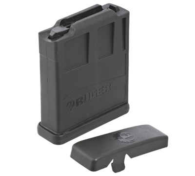

for you guys who have the 5.56 GSR, Ruger just came out with a 10 round polymer mag that will take up to a 2.5" OAL - Probably in the $60-75 range
AI-Style Precision Rifle 5.56 NATO/.223 Rem. 10-Round Magazine
http://shopruger.com/AI-Style-Precision-Rifle-556-NATO_223-Rem-10-Round-Magazine/productinfo/90562/

picked up a MDT polymer ten round mag for the 5.56 GSR, it took just a bit of file work on the back of the magazine to get it to latch in. Takes up to a 2.5" OAL. 4oz magazine vs 10oz for OEM steel
75gr Amax @ 2.442" OAL
I was going to say the same thing. Ordered the MDT mag, ground down the small tab, fits perfectly. Plus MDT is a CGN sponser, always happy to throw business their way.
