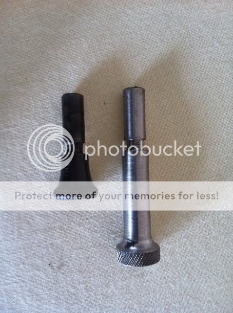

So I got my 64B all back together with the mods and some cleaning of rust this weekend.
the cocking handle before
The Cocking handle after
The new machend part beside the old one. I blued it myself as well.

The purpose of the extended cocking handle. With the scope I could not get to the cocking handle.
