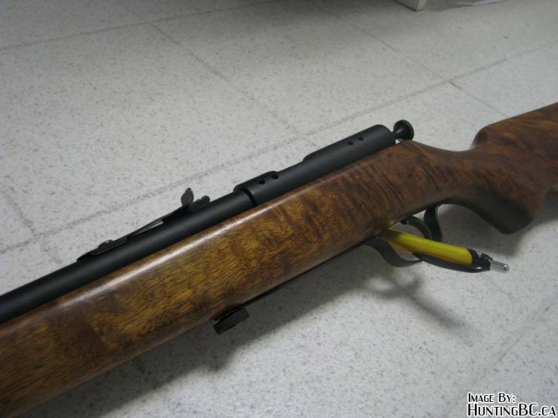

here is my old model 60 , not sure on the exact year but it does not have a serial number so older then 1962 (if my memory is correct). I redid the stock with a dark walnut stain and minwax semi-gloss clear coat. I also tried re-bluing for the first time, I redid everything but the mag tube. I was hoping for it to come out really dark but it would not go any darker then it is so I'm thinking flat black paint now.
here it is before, I machined a bigger bolt knob for the wintertime, stock one is to small and slippery with gloves on.
here it is now.

OK, here is my contribution.
I wish now that I had taken some before picts, but didn't think of it at the time.
Stock was dinged and scratched, but not too badly, the finish was cloudy, and the wood grain was barely visible under the finish.
The metal was rusty and pitted, but the bore was good.
Once I got into the project, I took a few "in progress" pictures, and of course some "after picts".
Used Circa 1850 to strip the stock, cloth and an iron to bring out the dents/dings in the wood. Sanded with 320 grit paper, and finished with Tru-oil, sanding with 0000 steel wool between coats. Initially, I couldn't decide what I liked better, a gloss or matte finish, but I left it glossy, and am very happy with how it looks.
Finally, everything put together!
I am glad this topic was "stickied"! It gave me the idea to try this!:)
I learned quite a bit from the other posters here. Thanks for sharing your tips and tricks!
james01 that stock is beautiful. How many coats of Tru-Oil did you use?
Thanks!
8 coats in total, with lots of light sanding between coats with 0000 steel wool to knock off any runs or debris that settled on the surface between coats.
After stripping, and before appling any Tru-oil, I lightly steamed the wood with a kettle to raise the "whiskers" of the grain and sanded them off with 0000 steel wool.
The wood was shiny and smooth as glass before I put the first coat on. I think I learned from this project that the prep work is just as important as the finishing product in how it turns out.
James
