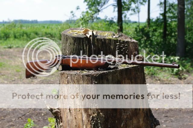

This is my Cooey Model 39 which I bought for 5 bucks in 1970.
Back then,I cut down and reshaped the wood to mimmick a straight english
stock and gave it a few coats of Tru-Oil to bring out the figure. I tuned the
trigger to a 1/2 lb. pull and thinned out the front sight blade to a fine edge.
The next thing I did was replace the stock screw with a Robertson machine
screw that I cut and shaped to fit.
I've shot more critters and targets with this rifle than any other that I've
owned and it still shoots as good as when I first got it.
Cooeys are good,honest & accurate rifles if well tuned and cared for.
