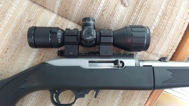

First let me say great thread I really enjoyed reading it. I have the same ruger takedown that I picked up about a year and a half ago when I got board with other hobbies and decided to get back into shooting. I researched the web quite a bit as I wanted to scope the takedown but still have it be useful as a survival rifle and this is what I came up with.
UTG bugbuster 3-9x32 with AO. At only 8 1/2" it's small enough that the rifle still fits nicely into the bag for protection and for $125 it includes quick disconnect rings which DO hold zero when re-installed but it can be removed in a couple seconds if desired. You need a new rail as the supplied ruger one does not have enough slots to fit the short scope. I went with the utg tactical shoot through rail and when the scopes removed I can JUST see the iron sights. My humble opinion its a perfect match for the takedown. I was a bit wary of a brand I hadn't heard much about but after reading the reviews gave it a chance and glad I did. Very accurate and seems to be build tough as can be. Guys are using them on .308 AR's and like them. Hard to find up here in shops which sucked but you can get it online from a company that starts with an A that has free shipping and they also carry the rail for $15.
If you want head shots on small game to fill the tummy this will do it at a lot farther the 25m.
