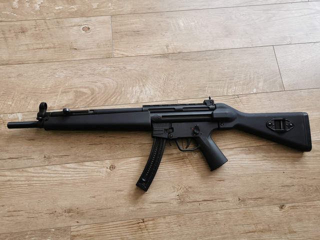

Woohoo! New one is below. Added a Navy lower and playing with a steel and aluminum MP5A3 stock (not fitted yet just placed for photos).
Thorsbear, that looks great man! Love that MP5 A3 stock. Is that the GSG 522 version or real MP5? Last real one I saw sold for $1100! I am trying out something similar but B&T mp5 version.

Hello Shurick,
Your B&T is awesome (and what is that 5 position adjustable?)
The MP5A3 stock that I am using is the VCF GBB V2 model. It's a direct copy of the HK including the slide lock and dissasembly procedures. Funny that they copied HK in making it a one position locking but didn't upgrade it to a 4 position :)
I'll take some closeups so you can see it better and show the issues with fitting it to a GSG16 (nothing unsurmountable)
My plan is to mill in additional notches to make the stock a 4 position adjustable for the kids and mount it to my G33 GSG16 rifle project
