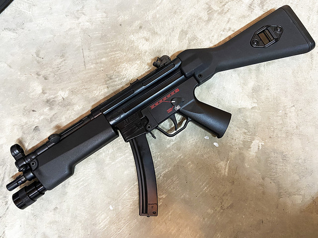

Another Dlask Build with 522kit that I just finished!

Got to shoot mine today. What do I mod to make it cycle with regular 22 ammo? I couldn't get it to cycle more than 4 times, and it stovepiped twice in 3 mags. It almost seemed like the rounds were ;racking; inside the mag and coming up on an angle.
Also interested in a better rear sight (its way too damn small, the front post completely fills it!) or even an RDS with the mp5 style frame.
