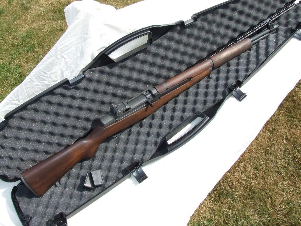

The bad: I messed up the install somewhere, the clip won't fully insert. The bolt (op rod) catch has a problem somewhere, it's usually not holding the bolt/op rod locked open. For both issues I am confident that it's an installation f up - it's my first time doing this - rather than a material problem. When I have an opportunity I'll break it down again and check what I suspect I already know is the issue, likely the op rod catch. This page should have everything I need to sort it all out.
