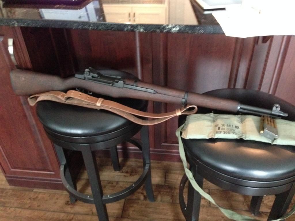

Wow!.
That is one seriously purposefull looking rifle.
Care to share with us how you went about re-finishing the receiver and gas cyl., etc?.
Man, if that one shoots even half as good as she looks ...![]()
