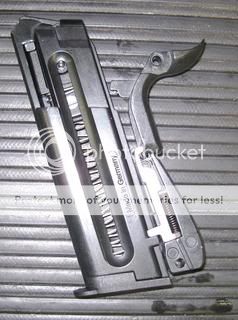

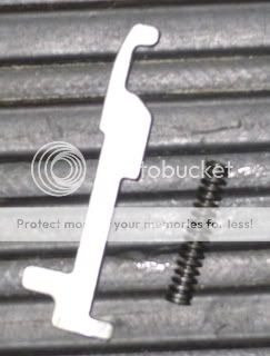

There is a part that looks like this:

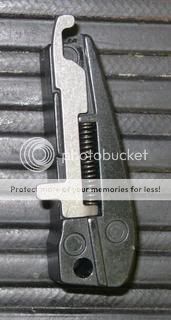

It is located on the spring housing:
Under the tension of that little spring,
that part works as an "arrestor"
by restricting the movement of the beaver tail.
Therefore, the gun cannot fire because the beaver tail cannot be pressed.
When the mag is inserted, then
the tab on the left side of the mag pushes up the "arrestor",
which, in turn, will un-lock the beaver tail safety (that is,
the beaver tail can be pressed now in the "fire" position).
By removing the "arrestor" and its little spring, the
the gun will fire without a magazine.
