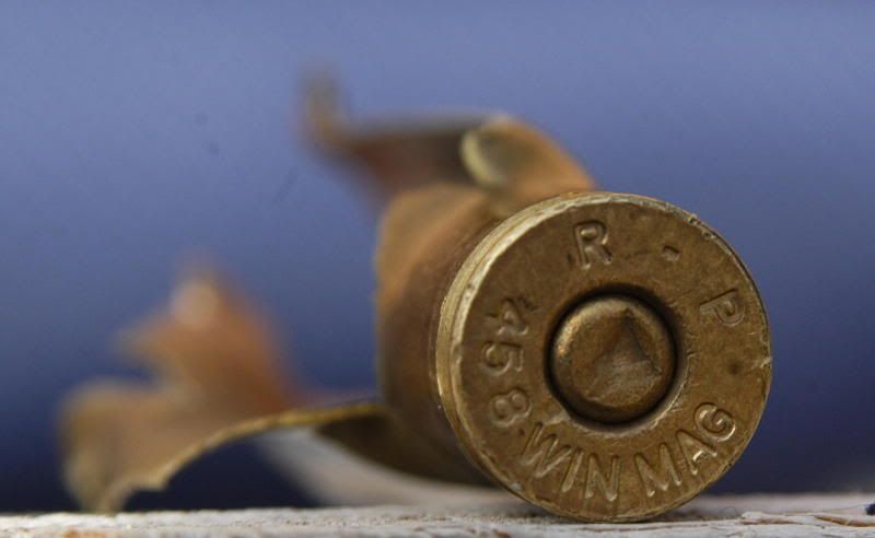

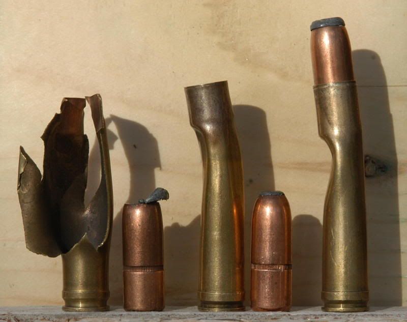

We're still not sure how the round fired in the magazine. The way I understand things is that a lead bullet can't bounce when it impacts the front of the magazine wall, particularly when there is pressure applied to the rounds by the follower. Once the round is against the front of the magazine, the round should have stayed there, but obviously something happened and the simplest explanation would seem to be that the round bounced back against the rear of the magazine and perhaps some carumba in the mag got between the round and the rear mag-wall causing it to fire under recoil.
The only other explanation I can think of is that perhaps the priming compound had come loose in the cup and recoil impulse was sufficient to cause the loose priming compound to impact the anvil and fire. If that is what happened, I've never heard of it before, but we are at a loss to find any other possible explanations. Pounder checks his rounds, both factory and handloads, and there is no chance that he missed a high primer.
This is the order of the rounds in the magazine, it was the top round that fired, squashing the lower rounds.
The primer provides more questions than answers. Was the strange indent the result of the round impacting the rear of the magazine in recoil, firing the round, or did it impact the rear of the magazine after firing? We assume the primer stayed in the primer pocket because the pressure inside the case was rapidly relieved after the case failed.

Boomer - it doesn't look like a big enough hit on the primer, does it? On the other hand most .458 loads are compressed, so how would there be any movement of the powder or priming compound? Very odd indeed!
I don't think there was movement in the powder charge, but if the priming compound had somehow started to float around within the cup perhaps the recoil impulse could have caused the primer to function. As I said though, I have never ever heard of something like that occurring, so if that is what happened, it must of been a one time in the history of the world event. And that is the most disturbing thing about the whole incident, there was no one thing you could point your finger at and say, yes that was it and we'll avoid that in the future. So, I am no longer comfortable with the idea of a short round in a long magazine, as would be the case of the .375 Ruger in a CZ.
I don't think it was a coincidence that this one time, never heard of before event happened in a heavy recoiling rifle with an over sized mag box....the only rifle of it's kind that I can think of. It has got to have something do with the cartridge slamming back and or forth.
