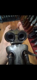

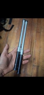

These are savage four tenner tubes inside a 1877 Husqvarna. Its dirty as i just got back from the skeet field
