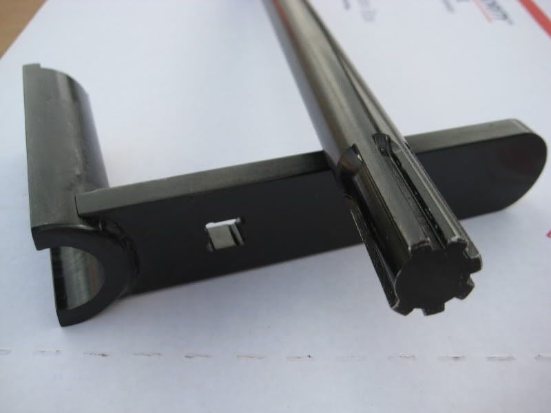

SL8/ G36 Tools: Barrel wrench and trunion rod.
These are used together to properly remove and re-install the barrel. The rod takes the pressure off the receiver so that the trunion is not separated from the receiver during torquing. Factory spec is 66 ft-lbs. Most people doing barrel changes only go to 45 ft-lbs.

For anyone whose a 'thrify' as I have to be I was able to make these in about half an hour with some 3/4" metal rod and one inch iron pipe from home depot. 10 bucks all in. Not nearly as pretty but it works. Just copied the plan pic, scaled it on a work copier to the right size and glued it to the end of the rod. then it was just grinding out the empty spots with a dremel... done!
Same for the wrench... although access to a welder for about a minute helps with the handle:D
Good work. How long did you make the flutes in the trunion rod tool?
I'll need to add that tool spec to the first page.
All of about 5 minutes. It took longer to cut out the stencil. Never was good at keeping it between the lines... on pretty much every level:D
