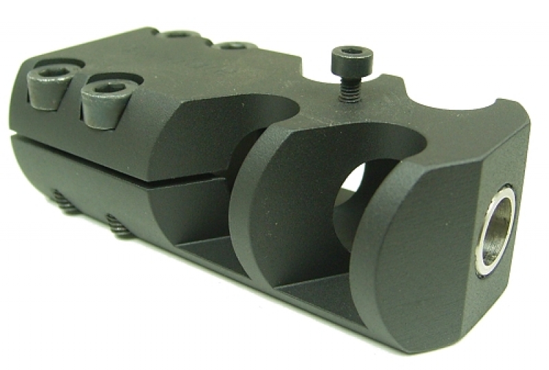

I've just started to build out my SL8, ordered the muzzle break today from roedale precision
