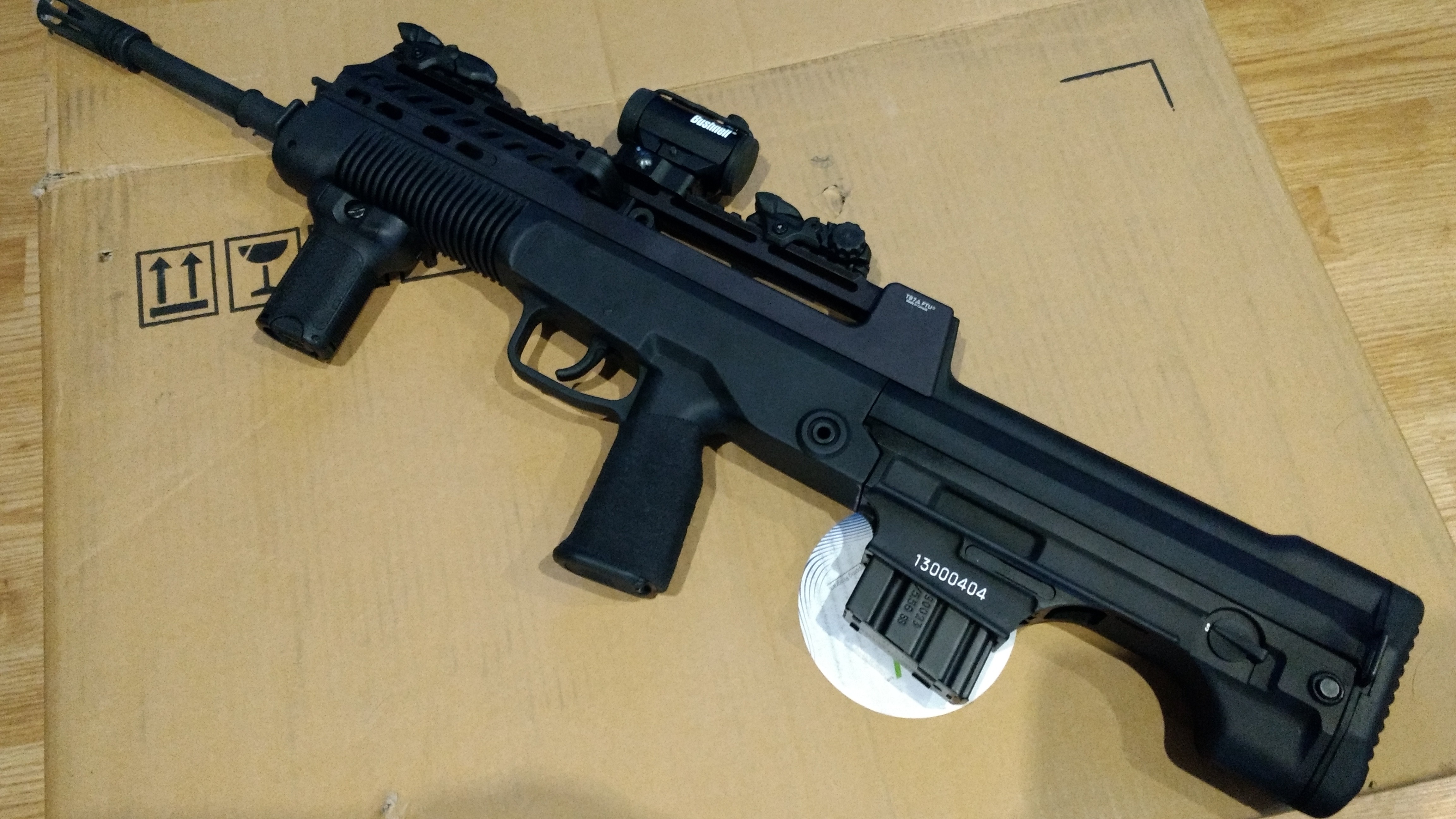

Going to venture into unknown territory and try to install a Troy Ambi mag release on a T97. Should work but will require some grinding, drilling and retreading the T97 push mag release to fit the AR release.
Keep u posted..
