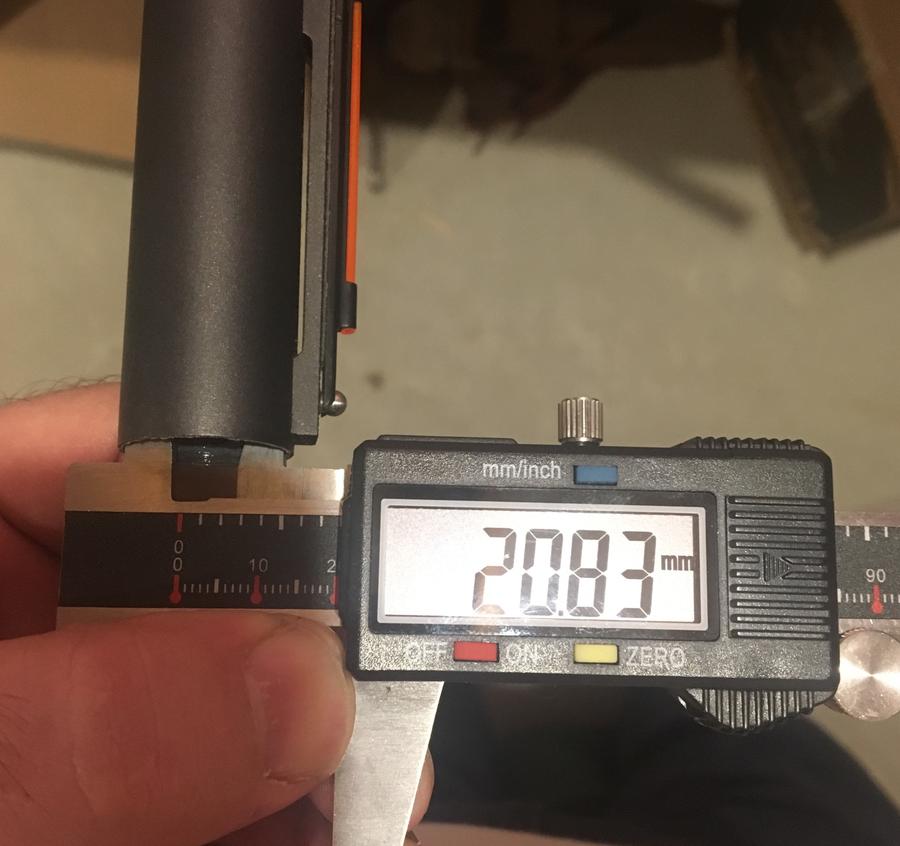

I dont get it a 12 gauge is 0.729" bore witch is 18.52mm and 10 gauge is 0.775" witch is 19.92mm so both under 20mm
Please explain
any shotgun with REMOVEABLE CHOKES .... THE REMOVABLE CHOKE IS NOT PART OF THE BARREL ie your bore diameter is over 20mm.

The choke being removed doesnt make the bore a usable 20mm. The last 3" of the bore is cut out to fit the choke sleeve. The bore leading up to that cut out is still the caliber size.
Really putting the horse before the cart on this one. Choke installed or not, the USABLE bore size, the size that the projectile needs to be to fit down the bore from the breech end, is legal. Cut the muzzle out to 50mm....doesnt make the bore of the rifle capable of shooting a 50mm projectile.
There is no reasonable scenario where the diameter of the bore is measured with a choke installed. Unless maybe if the choke was welded into place. If there was, it would mean any rifle that should be included in "bore of more than 20mm" could be threaded and a device inserted to render their bore less than 20mm would be taken off the list. Basically, measuring the bore diameter of a firearm with a removable device installed would completely cancel the very concept of bore diameter.

On a side note, the debate is a bit rhetorical. At the end of the day, some shotgun gets banned. Anything 9G or larger (I just checked, and it seems 8G shotguns exists, although they are rather expensive), even with choke inserted, is more than 20mm.
Heck, a 10G is 19.69mm, so a 10G that would be even slightly out of spec would be prohibited. Who wants to bet a few years of jailtime that their 10G is less than 0.3mm within spec?

From my Rem 870: 20,83 mm diameter at the end of the barrel, with choke removed.
