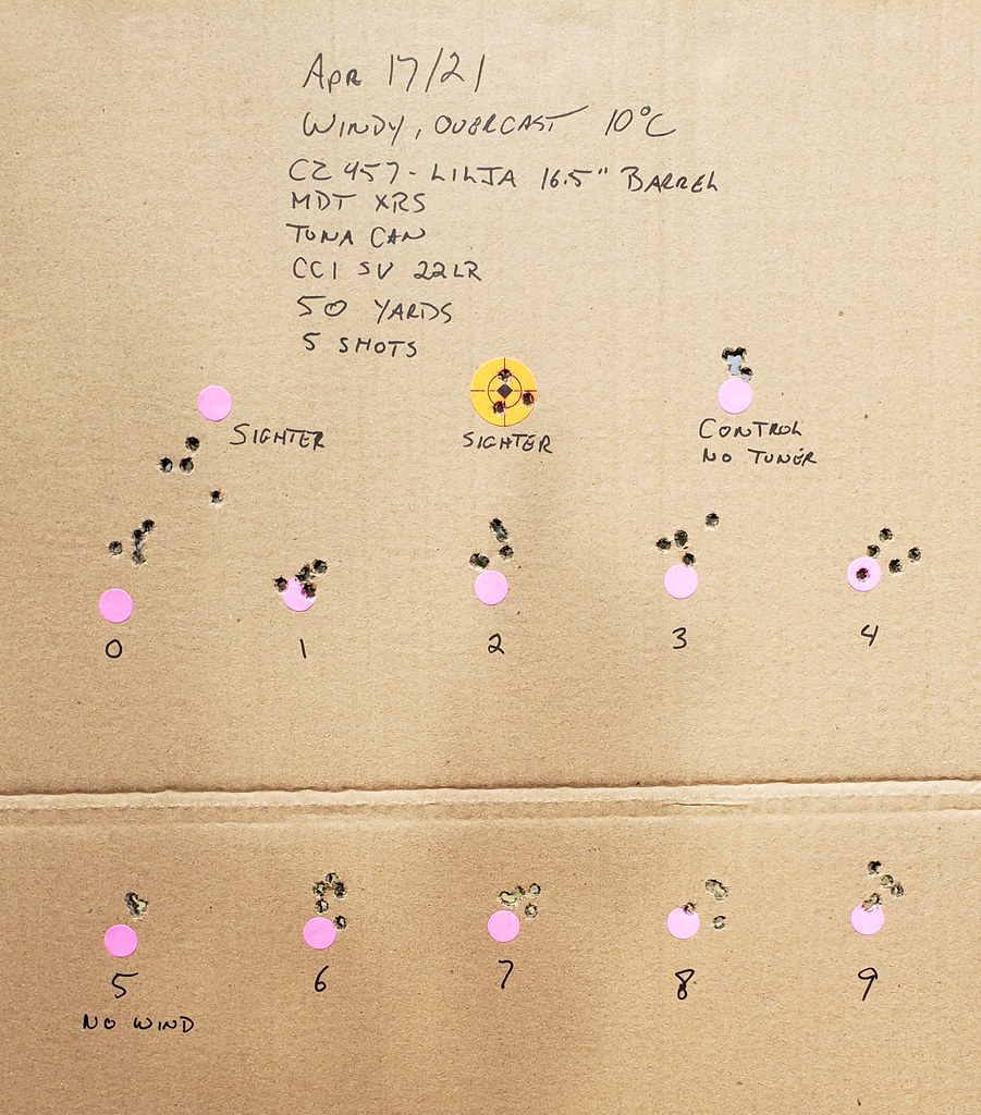

Tried out my Lilja barrel CZ 457 XRS with the Can and #5 produced the best group today. A bit windy but did my best waiting for a no wind moment.
#0 - #9 is the setting on the tuner. Others may note it as 0.1 - 0.9.
One full turn is 0 - 9. Beginning a second full turn I will be documenting it as 10 - 19 and so on.
For now I'll be keeping it on #5. I'll be minimizing my testing as bulk CCI SV ammo from my LGS is non existent at the moment.
He stated #5 produced best today, so each was a different node setting.
Compare #5 to control w/o Tuna and there is significant improvement.
Yes, indeed. The ROC did say target #5 was best, but I wasn't sure if the numbering on the target was for groups or a notation indicating tuner adjustment.
Thank you. This confirms what Gimpy knew and I didn't.
It will be interesting to see ten or more groups shot with the tuner set at #5 or 0.5 look like.
As a note of caution to readers in general, one group out of ten shouldn't be seen as conclusive or reliable evidence of how well this tuner works. Nor can a single "control group" without the tuner be a reliable baseline against which to compare the ten groups shot with the tuner.

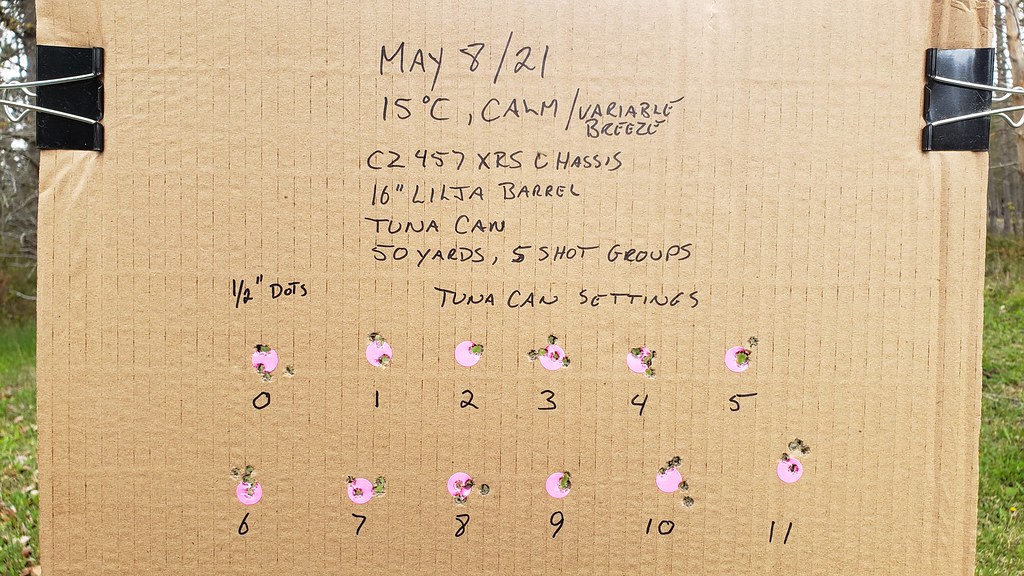

Took advantage of a calm afternoon today to re-test the TC and confirmed setting #5 is good but also discovered #2 and #9 produced great results as well. Going to go with #2 now.
Absolutely awesome shooting ROC. That’s super impressive with reasonably priced ammo. Good for you!!
On one target it's noted that the ammo used is CCI SV. Was it used for the other target as well? It should be noted that this ammo is often inconsistent, easily producing a variety of group sizes even with top quality barrels. In order to have confidence in testing results, better, more reliably consistent ammo may be needed.
Two targets are shown, with the one dated April 17/21, and also posted originally on that date. Then, as now, it was noted that tuner setting #5 produced the best results. The newer target, dated today, May 8, shows tuner settings #5 and #9 producing the best results. Nevertheless, on the older April 17 target, tuner setting #9 produced poor results. Is setting #9 partial to May but not April?
To help determine whether the tuner is doing something good, shoot ten five-shot groups without a tuner. Then shoot ten five-shot-groups at setting #2 and ten five-shot groups at setting #9 to see if the results are better than the tuner-less groups. That can help verify the results. Single groups aren't reliable, nor is ammo such as CCI SV.
