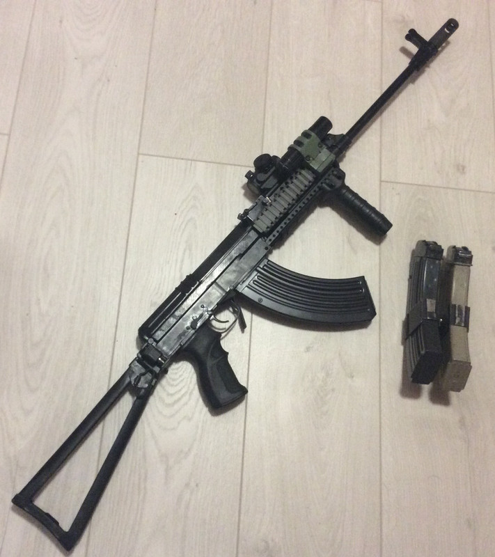

Wow that looks great! How difficult was it fitting the stock and handguard? Links to where you bought them?
That stock is a Frankenstein custom job - a Russian AKS74U stock cut and welded to a Vz58 folding stock adapter, and then attached to the T81 via a Foxstrap Vz58-to-T81 stock adapter. The RAS was an old Vz58 quadrail; it fit fine, but the tabs to attach the upper rail needed to be removed for the upper handguard to fit - there was no way to make that upper rail work on the T81.
And sorry, no links available... all of the parts on the T81 were pulled from my old 858 when I sold it years ago.

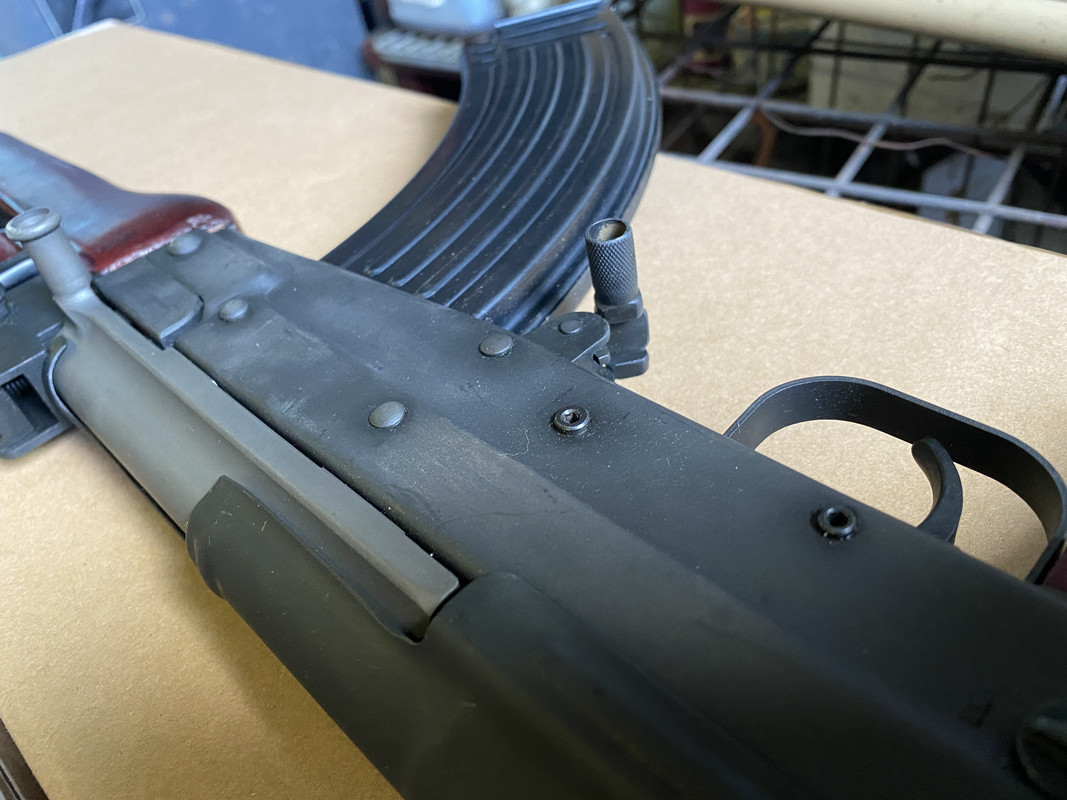

Having used my type 81 a couple of times I find that it's pretty user friendly with the exception of the mag release.
Some want a larger charge handle where I find it tidy and sufficient. Even the right hand safety I find is easy enough to operate with my right hand thumb while still maintaining a good purchase on the pistol grip. I think that I might eventually change the stock to something that has an adjustable LOP.
So in the meantime I was annoyed by the mag release and came up with a solution. I took a hammer extension for a 9422 and modified it (cut and lengthened)so that it was wide enough to slip on the mag release without permanently altering the release. Once I use the rifle a bit more I can decide if I want the release on the left or right side.
