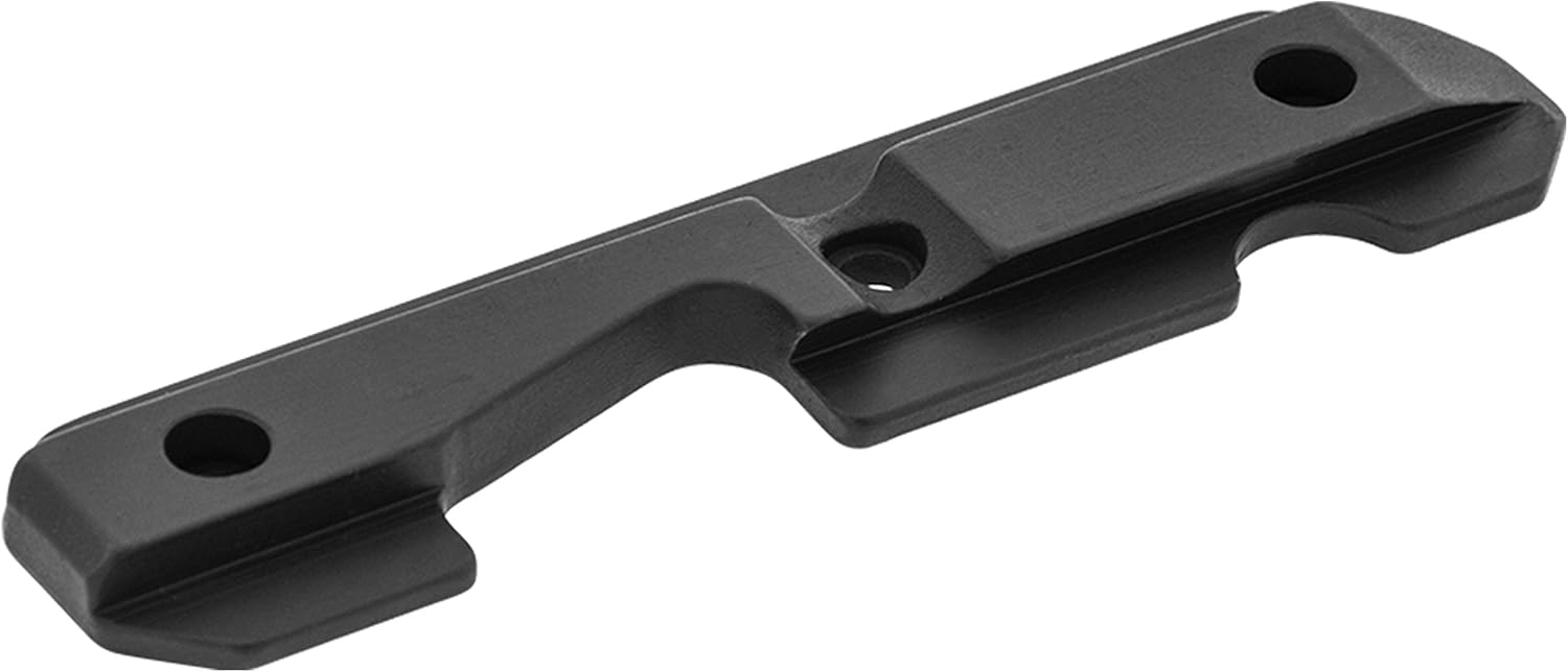

Appears to be a generic AK side rail you can buy from a lot of places. Not sure how it's attached though, looks like the rivet holes would get in the way of the mag well or magazine release with it mounted that far forward.
It reminds me of the RS Regulate setup I saw someone post on another site.
Any idea which RS Regulate people are buying? What gives the best height and fit?
Most are running the 303M (full length lower) over the 302M (picture, rear biased). There are a bunch of upper optic mount options but the AKR 1913 is the biggest pic rail that allows for the most versatility. The challenge is finding the base plate and lower rails. If anyone has a lead on an RS 303M or CSA VZ-58 side mount please post up or DM me.
Anyone remove (grind) the small raised lips on the TI picatinny rail base? I think that if I do that it will center on the rifle better but I am worried that it might prevent it from coming tight.
The CSA side mounts don't line up with the holes for the OR mounts.
So to answer my own question. I went ahead and removed the proud lips on the rail base and it drastically improved the rail position with no effect on the ability to clamp the rail on. I also shimmed the rail base 6 thou at the rear pin to compensate for the 1.5 mm over 40cm right deviation in the barrel to receiver makeup. I believe that the rail now is close enough for the expected accuracy of the rifle.
the t81 pic mount not designed for AK or VZ rails so with those removed i wonder if they fit now? im guessin not.
I don't have any other rails to test but on gnutzguy's video he mentioned that the mount base rail was thicker on the the TI version. It's possible that it might work with those removed. It's almost as though the base was designed for a different rail system that had reliefs machined into it for those to sit in. I don't by that it's intentionally designed to sit canted to the left. I am struggling to find any reason why that would be an advantage in any scenario.
