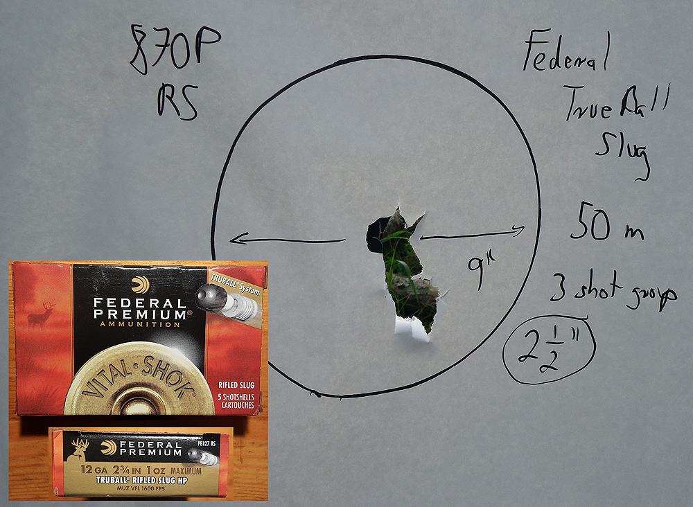

For today the Challenger slug is the clear winner when it comes to penetration. It is a pity that it is not more accurate … I only got a 10 inch group at 50 yards/meters with the Challenger slugs. However, I get 2 inch groups with the Federal TruBall at 50 meters/yards ….
