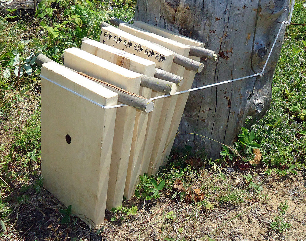

In order to find out … I was using my setup with 1.5 inches thick spruce boards.
I fired one shot of 12ga Federal 1 1/8oz Heavy Field load with #6 shot (1255 fps)…. and the muzzle of my gun was only 20cm (20 centimeters) from the target. Gun was an H&R 12ga Pardner single shot with fixed modified choke.
Here is the result …..

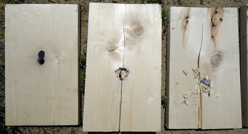

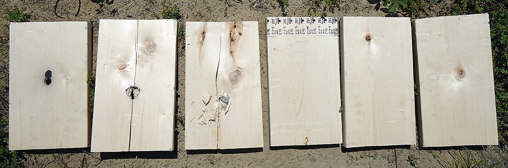

Front:
Back:

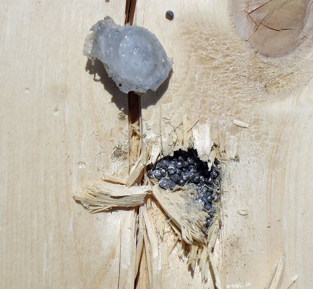

Close up of the stuck projectile:
In conclusion, that bird shot load at very close range (20 cm) nearly penetrated 3 boards of 1.5 inches thick spruce boards .... and it behaved very much like a slug. All the pellets stayed together. Buckshot on the other hand at 20 meters was not able to penetrate 2 boards.
Compared to the slugs that I tested, this bird shot load had around the penetrating power of a “sports slug” or a normal low recoil slug.

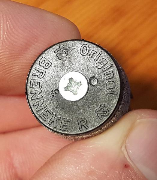

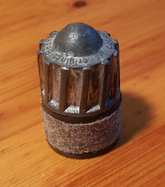

I only know that the slug of the Rio Brenneke is actually an original 1 1/8oz Brenneke slug. However, Rio decided to load it to a velocity of 1410 fps ... and that is pretty low compared to other better penetrating slugs ... For example the Challenger slug has the same weight but runs at 1610 fps ...
Here two pictures of the Rio Brenneke projectile ... it has "Original Brenneke" embossed on top and at the bottom ....
