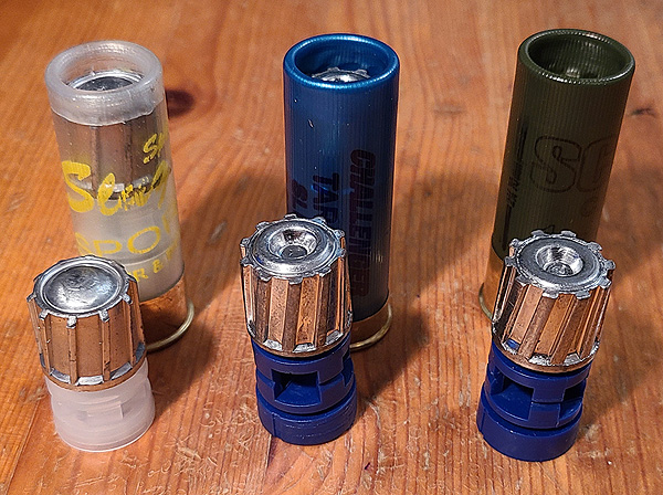

From left to right:
1. Sellier & Bellot Sport Slug: 1oz; 1345 FPS
2. Challenger Target Slug: 1oz; 1450 fps
3. Score Competition Slug: 1oz; 1300 fps
( link )
Observations
The Challenger and the Score are the exact same slug and which Ballistic Products sells as the "Thug Slug 12ga 1oz". The only real difference is that the Challenger is loaded to a slightly higher velocity. All three slugs are hollow Foster type slugs with an attached tail-wad that is supposed to stay with the slug during flight.
Penetration Test

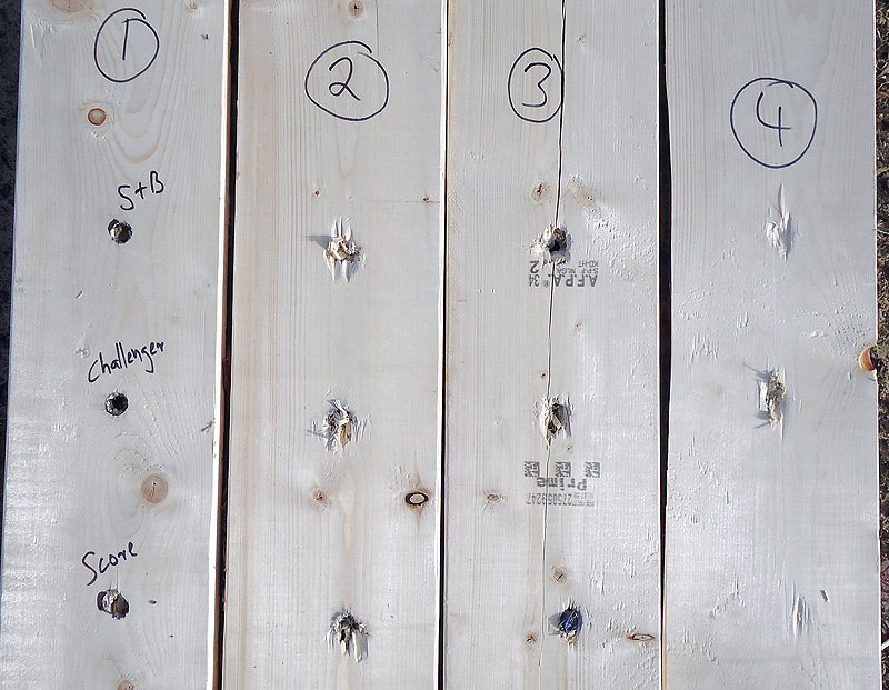

Setup was the same as described in my first test (see the first post in this thread), however, from past testing I knew that those slugs would not penetrate 4 boards. So, I set up with 4 boards instead of 8. Shots were fired from around 9 meters and with my 870 Police.
Penetration Result
No real surprises here. All three slugs penetrated 3 boards and I recovered all three slugs from the back of the third board. All three are “Low Recoil” slugs. The Challenger seems to have a little bit more “umpfffff”. It left a larger/deeper dent in the 4th board.
( link )
(Link to high resolution image)

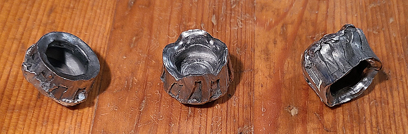

Recovered Projectiles
From left to right: Sellier & Bellot, Challenger, Score
( link )

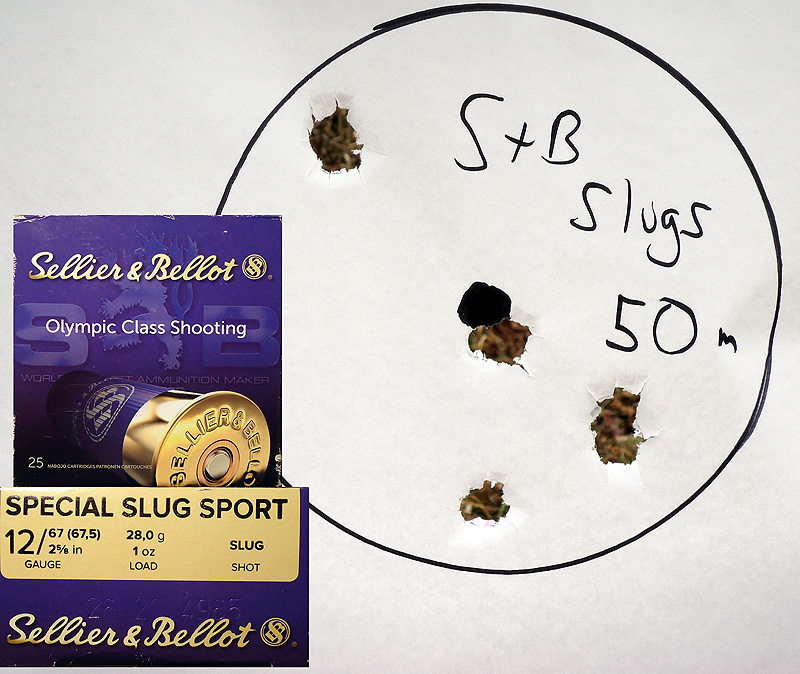

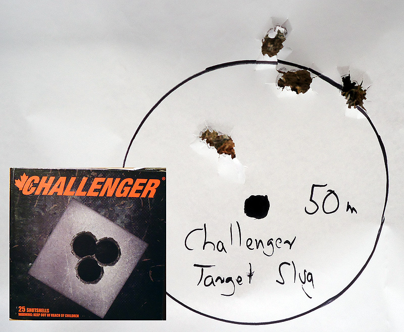

I tested all three slugs today for accuracy at 50 meters and from a bench rest … and here are the results. The gun was my trusted 870 Police with Ghost Rings and a fixed Improved Cylinder choke (link to image). The circle is a pie plate, 10 inches in diameter. 4 shot groups!
The group today confirmed what accuracy I normally get from the Sellier & Bellot.

With respect to penetration there were no surprises. All three slugs are low recoil slugs with the same weight, 1oz … and between 1300 fps and 1450 fps velocity. So, we are talking Brown Bess territory. All three slugs penetrated 4.5 inches of solid spruce wood.
And with respect to grouping …well, I was surprised by the group that I got with the Score slug. Honestly, I did not expect that. I think I will test the Score slugs once more in the future … and I might switch to Score slugs for my target practice …. :)
