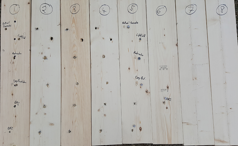

Last week end I finally got around to testing another 5 slugs. For one, I wanted to test lower velocity slugs that might have potential for penetration and that I could shoot and control out of my Tac-14. And then I was able to get a hold of a box of Lightfield Commander IDS Plus slugs and which exhibit impressive stats. This Lightfield slug is heavier than the Challenger slug … and has a higher velocity. So, the Lightfield has more energy going down range and I had high hopes that this slug might outperform the Challenger. But ….
I used the same method of testing as in the first test … stacking eight spruce boards, 1.5 inches thick, and shooting with my 870 Police and with IC choke from around 8 meters.
From left to right:
1.) RWS Rottweil Brenneke
2.) Lightfield Commander IDS Plus 3”
3.) Winchester Rackmaster
4.) Federal Deep Penetrator
5.) Winchester BRI Sabot
And here is the result:
Link to highres image:
http://kalypso.net/temp/Penetration-Test-3rd/P3rd-Results-Highres.jpg
1.) RWS Rottweil Brenneke penetrated 4 boards
2.) Lightfield Commander IDS Plus penetrated 4 boards
3.) Winchester Rackmaster penetrated 4 boards
4.) Federal Deep Penetrator penetrated 4 boards
5.) Winchester BRI Sabot penetrated 5 boards

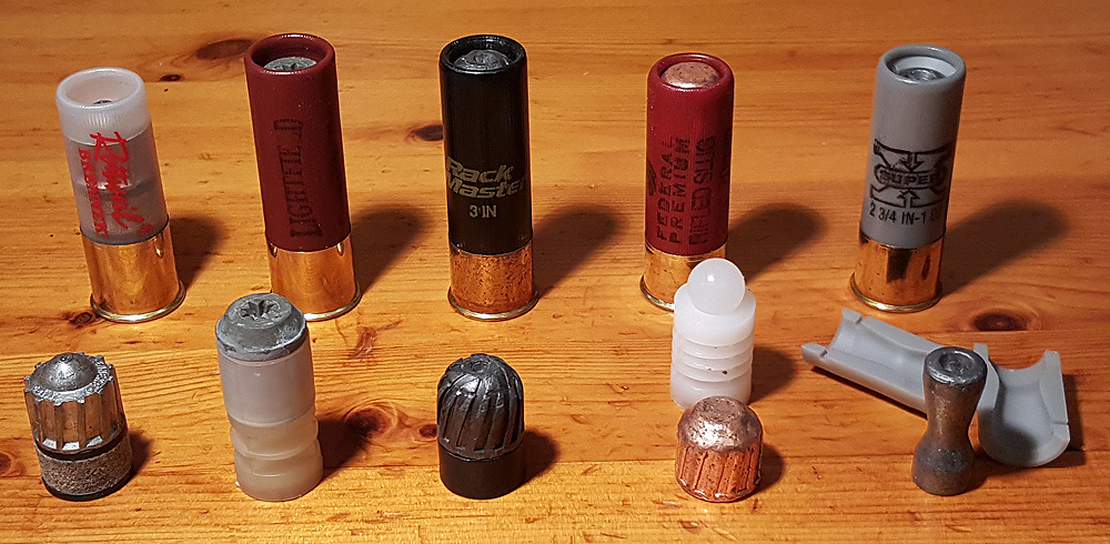

And here the recovered projectiles:
A couple of observations:
The Lightfield Commander IDS Plus has probably the highest energy of all the slugs tested. However, it mushroomed and flattened a lot and ripped impressive holes into board 2 and 3. But the slug lost it’s energy there and was lacking penetration.
The RWS Rottweil Brenneke slug (projectile) is identical to the Rio Brenneke. Both look exactly the same, have the same weight, … both have “Original Brenneke” embossed on the slug, and the recovered slugs after shooting look pretty much the same.
The Winchester Rackmaster slug as well flattened and mushroomed quite a bit.
Here are the velocities:
1.) RWS Rottweil Brenneke: 1427 FPS
2.) Lightfield Commander IDS Plus: 1700 FPS
3.) Winchester Rackmaster: 1700 FPS
4.) Federal Deep Penetrator: 1350 FPS
5.) Winchester BRI Sabot: 1350 FPS
