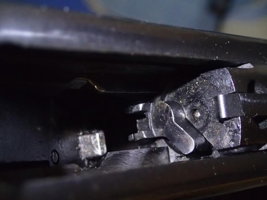

anyone else take their bolt out of their rifles?
I have been working on mine, I had a few parts fail completely. I got looking at my bolt, it is very rough, was extremely rough getting in and out and I found the bottom of the bolt was flared out badly to the point it was extremely difficult to get the bolt out.
When I got the bolt out I found that the bolt face was missing a part, looks like it was very roughly machined or broke off.
Does anyone know if the bolt supports the cartridge base, I do run fullish power loads through my gun...
Is this cosmetic only or something I should be concerned about?
I started looking at my spent brass, they all have the same line/damage across the primer and 2 dings in the case that line up with the missing supported area. Maybe I am WAY over analyzing this though... As I work up a hand load in the future I want to make sure my gun is supporting my cases correctly. EVERY piece of brass shows the same primer contact/damage looks like contact with the ejector?
The two dings are at the bottom by W-W and the primer contact goes from the R in super to the R in rem.
Any ideas folks?
Any ideas folks?
Looks like you are missing your ejector unless you just didnt put it back in for the picture. otherwise things look normal, but rough. It looks like a piece broke off on yours, but I looked at mine and it has the same cut, just cleaner and more straight. so I think you still have a functional rifle, although I cannot be held liable for mishaps :D

Here is a Pic of mine in the gun (It takes too long to disassemble).
Also it looks like you have your ejector assembly in the bolt in one photo and claim it to be missing where it is not present in another...?? Did you misplace it?
It is the primer flow or whatever you want to call it that worries me. All the parts are in place and ALL brass was fired while rifle still functioned 100%. I haven't been able to fire it since the cartridge guide failed...
I looked at it more and the primer seems to have been pushed into a gab between the bolt face and the ejector. The gap between the bolt and ejector is sloppy and that is where the primer seem to get pushed into. My worry is this is with factory ammo not some full tilt 300 grain hardcast load.
I am no gunsmith but primer getting pushed into cracks seems bad. It is every piece of brass. Maybe my rifle bolt isn't fully in battery, head space issue? I have no idea.

The two dings by the W-W are caused by the extractor not the missing area. I was able to line up my brass on the bolt and line up the primer flow and prove my extractor is chewing up my brass not the missing face...
Had a look at my boltface and it is not missing any pieces and I checked all my brass and no marks on them either. Yours does not look like mine.
Driller, no I took the ejector out for the pictures. All parts are here it is the damage/missing support area of the bolt on the left side if the bolt was in the rifle... It is clearest in the 2nd photo.
I am not missing "parts" as such it is the missing portion of the bolt face or support area. Maybe it is not there on any of the bolts.
little more info...
between my bolt and ejector there is 0.0215" of space, that space perfectly matches the damage to my brass/primer.
the missing area on my bolt face is 0.205" by 0.084" by 0.0425" it is a chunk that is just gone. not a missing part per se but missing steel.
the ejector sits 0.0215" out past the bottom of the bolt, it is the shiny part centered over my finger, doesn't seem like much but could it not fully allow the bolt to go into battery?
brass expands uniformly from 0.4555" to 0.4600" so my chamber seems uniform at least. :)
G.Mitchell, my ejector also sticks out somewhat. I find when I close the bolt it does rest against the receiver and the spring allows the ejector to move back so that the bolt can go into battery. I find in disassembly that it can be sticky, but once I get the gun back together it works fine. This is just from what I am seeing. I am not sure if it helps, but hopefully it does. I am digging out my gun again to see if my bolt has that small part missing in the right side.
Edit: on closer inspection my bolt does not appear to have this piece missing which leads me to believe that you do in fact have a piece missing from your bolt face.

Thanks driller212. Part of the fun of guns for me is tinkering. But sometimes it goes beyond that.
My ejector sticks out w/o the spring in it.
I'm trying to figure out if I have a lemon or money pit before I start trying to track down parts.
It's the blot face and primer issues that concern me.
I'll keep you guys posted on what I find out.
