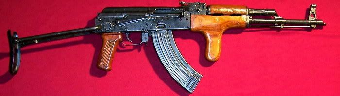

Now the Romanian pistol grip is going to be an interesting project
and I can’t wait for the results.
Me, personally, I’m from the old school
and I don’t mind a regular forend, meaning no pistol grip at all.
But from all the pistol grips I tried on that kind of guns,
IMO the Romanian one is the most ergonomic for any size of hands,
either bare-hand or gloved.
The angles and curvatures and dimensions are simply perfect.

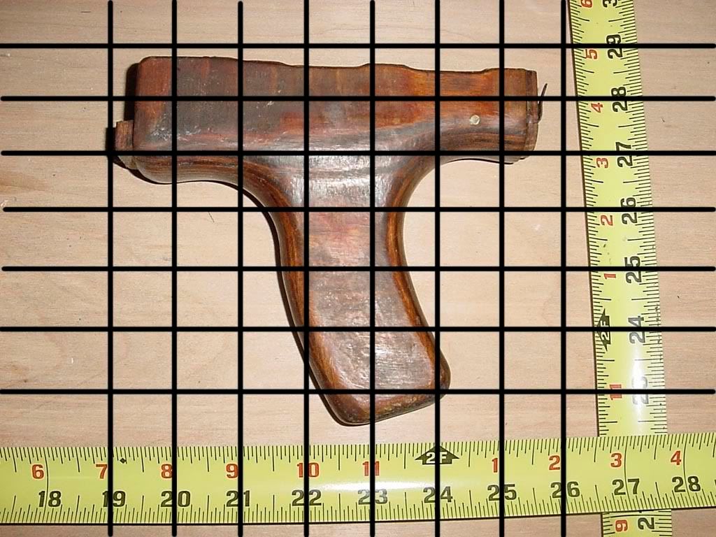

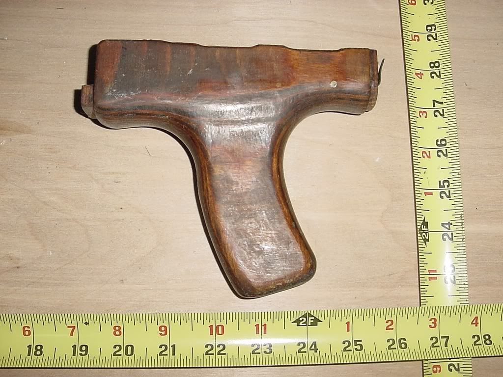

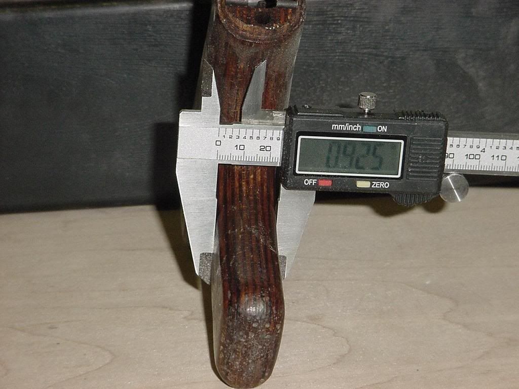

Just in case you don't have a Romanian handy,
I have 2 pics that I hope will help you with your project.
Please remember, all the geometrics of this (meaning the position of the
pistol grip on the forend, the dimensions and curvature) are important
for both ergonomics and for clearing the mag
(allowing plenty of space for tilting).

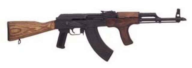

Here’s some more pics of romanians I’ve stollen from the net some time ago.
http://i69.photobucket.com/albums/i74/Dr_Lector/ak_rom_26.jpg
http://i69.photobucket.com/albums/i74/Dr_Lector/akm_rum_02.jpg

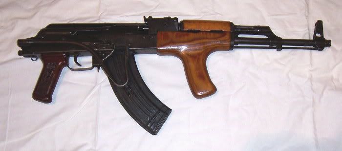

The (quite-rare) pistol grip for underfolder:
http://i69.photobucket.com/albums/i74/Dr_Lector/akm_rum_04.jpg
http://i69.photobucket.com/albums/i74/Dr_Lector/akm_rum_03.jpg
The export-only sidefolding stock 5.45x39
(Romania never adopted that stock or that cartridge in the cold war):
http://i69.photobucket.com/albums/i74/Dr_Lector/rum_aim_01.jpg
http://i69.photobucket.com/albums/i74/Dr_Lector/rum_aim_02.jpg
Keep in touch and please post progress reports.
I have done some measurements. The only thing is that the grip has to be very forward so that the mag can be taken out. So imagine that grip pushed forward. I need more dimensions, more than thickness. Thanks.

Anybody out there got a CAD/Drwg program that can overlay the Dr. L's inch grid for a pattern, and post the result../
'Else it's 'back to school' for me and software...and s**t, we just don't get along..

Because this photo is not totally vertical there is some distortion. If you could take one vertical with a 2 foot carpenter's square next to it the grid would be more accurate. Sorta like CSI.

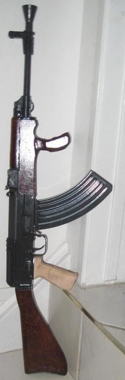

This isn't the first time I've tried. I made a lower handguard from an enlargened photocopy. I found the problem being the close proximity of the grip and the magazine. I had to unlock the magazine and pull it straight down, not rock and drop.
My second try moved it forward somewhat, and there was still a problem, so it cut it smaller and shaped it into this...
It is highly ergonomic, but weird looking. I will try now to make a classic Romanian grip, but more forward. If I can.
