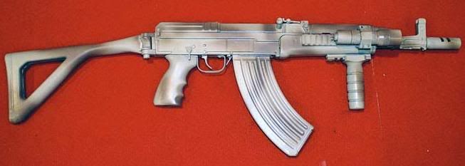

This was forward to me. I don't know its history...
Deckard said:
Many people prefer the AKM, but the VZs at least can be obtained these days.
Does anyone know where you can get a pistol grip like that in Canada? I NEED one!
The stock and grip are made by a Czech manufacturer. They are on a CZH2003-S I have a sample package of stocks and grips enroute.
Hey, dead ###y! If I can get CZ858 and dress up like that, then why the hell not? Now I really gotta go get one :)
Oh, those install on CZ-858, right? Not just on VZ-58? Right? Right?
